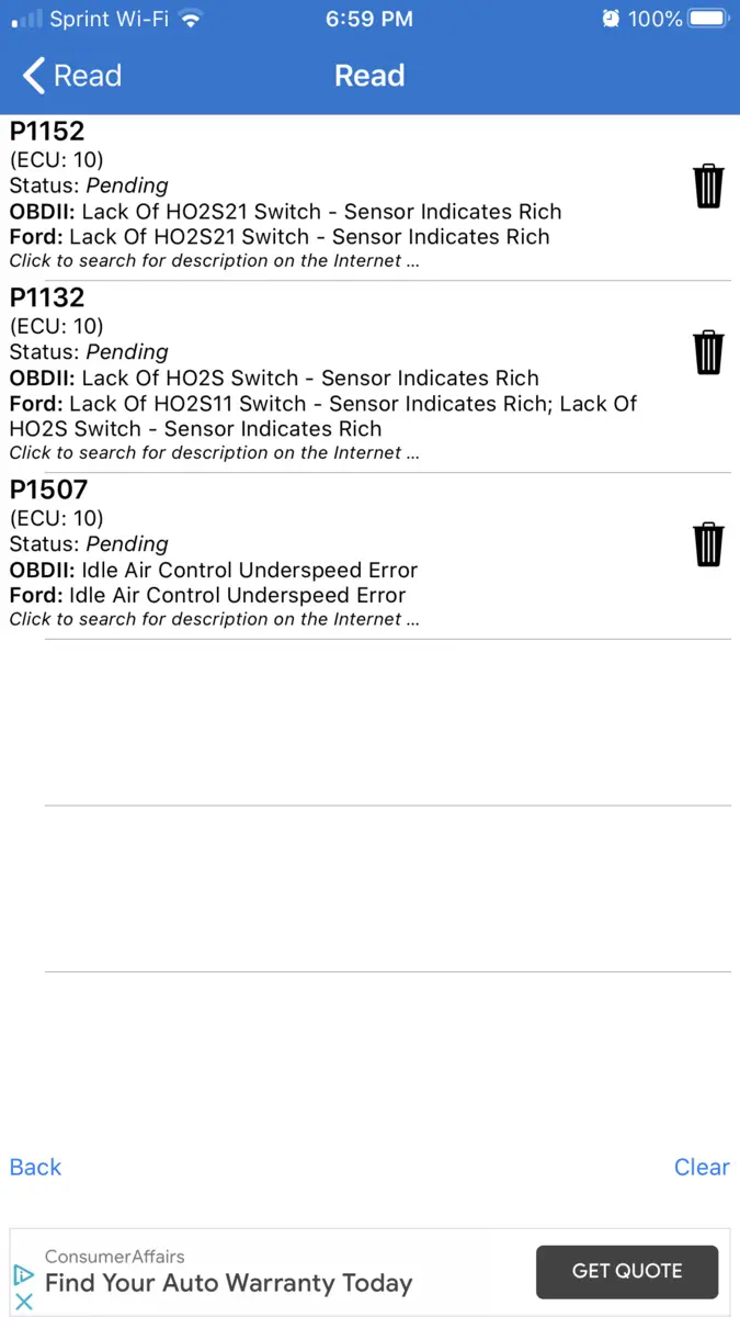

I got a wild hair the other day and bought a engine code reader from amazon. Veepack OBDCheck Ble. I tried messing with it but I was at my wits end and didn’t have the patience to set it up.
any takers? You guys have been a tremendous help so far. Thing is, this car ran perfectly before all this happened. hopefully it’s something as easy as an oil and transmission fluid change. Maybe some other sensors. When I get the code reader set up I’ll post the findings. Gotta research what app works best with it.
