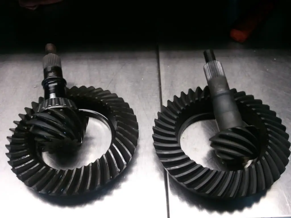

Motive Gear F888456 for the rear. And this rear end rebuild kit.

I'm running the d35, which I believe is reverse cut. The rear is the 8.8 LS. Both will get 4.56 gears.

Also, if any of you have noticed one or both of these gear sets are really noisy, please let me know.

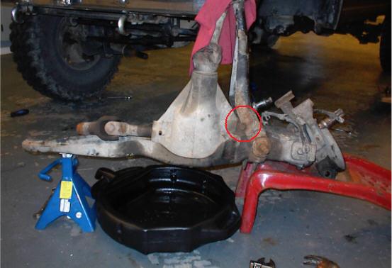

Hey, I usually try to share this cheat with guys taking their d35s apart, Don't know if you know already but you can notch a little bit of your radius arm to get at that bolt, otherwise you have to remove the radius arm. I ran mine hard for a few years afterwards when I put an EZ locker in, You will see what I mean when you get after it. Good luck!
BAD idea.
You're asking for a stress crack to form within that notch.
Much better is to grind the bolt's head into a "D" shape, then you can wiggle it past the radius arm (also stick the bolt back in from underneath next time, there's a bit more clearance for it that way).

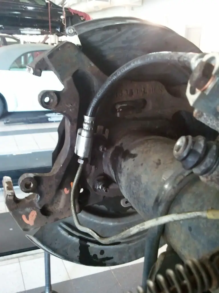

I also think I figured out how to keep the 92 brake hard lines on the axle with the 98 calipers. I just bought another right side rubber caliper line. I'm going to use one of the backing plate bolts to hold the block that the hard line and soft line connect to. I'll post some pics when I get it all together.

BAD idea.
If you seen how hard I rode mine after, you would probably reconsider. If I couldn`t get it to crack, I doubt anyone else can. Just enough to get the nut out mind you...

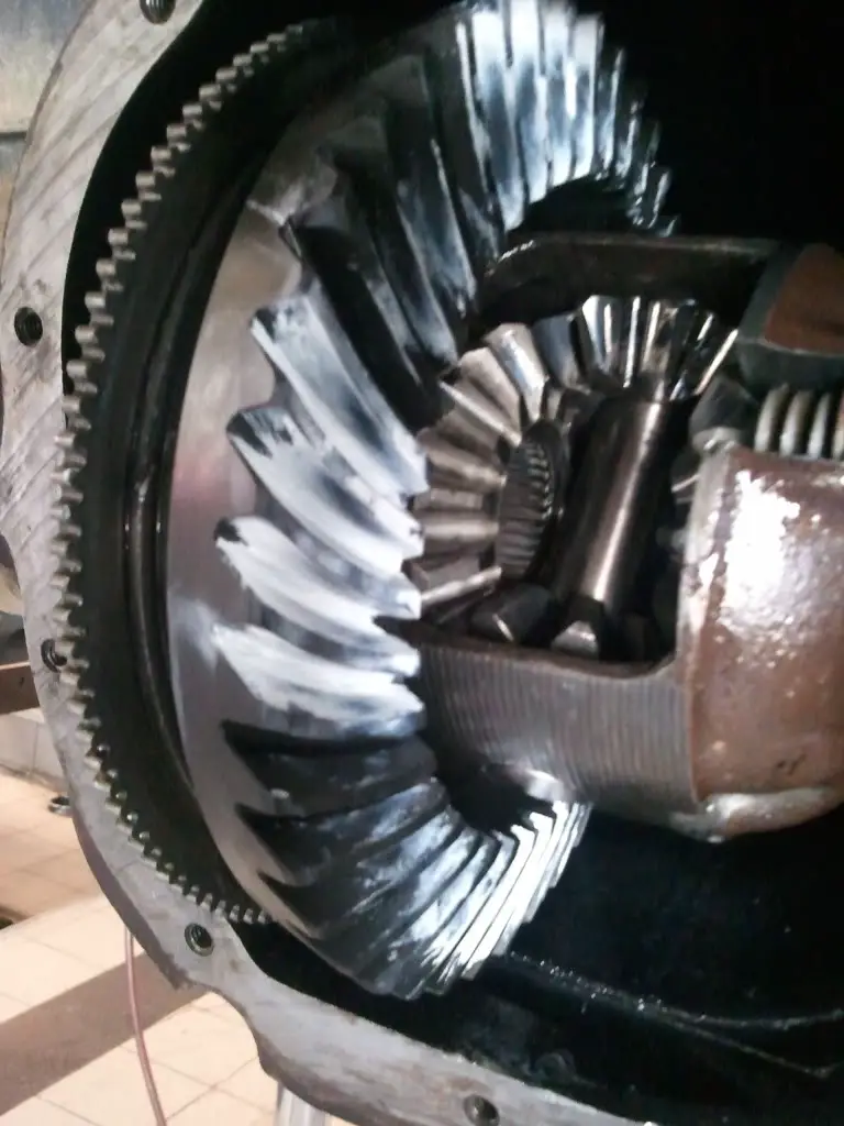

Well, it took over 16 hours, a little blood, and many expletives. But I finish the rear. Well, not really I still don't have a parking brake.
I finally got the bearing races off of the carrier, and the new ones pressed on. my master kit came with the wrong wheel bearings and seals. Bought new ones. I packed the LSD with two extra friction disks.
Had to pull the pinion three times to get the right backlash and ring pattern.
When i was nearly finished, all four caliper bolts walked off some where. So I had to buy new ones. Never did find them.
I am very happy with the gearing. I defiantly have a bit more giddy up. The LSD is so smooth. I can't tell when it unloads.
