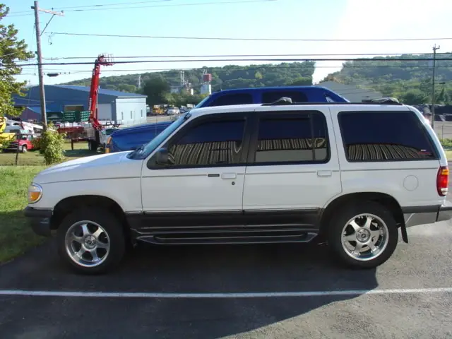

Well, what are you looking to do? If you're looking for big tires, no you won't be able to fit very big with that drop in the rear. If you're looking for low profile, then you should be able to cook something up with that, however, I don't have the slightest clue about low-pros, so maybe someone else will :D
no they wont! you should buy mine instead! :)
I am dropped 6" in the rear, I am tucking quite a bit of rubber, and the widest tire I could fit in there is a 285. So in the rear I am running 285/50-18's on a 18x10 Saleen rim with +24mm offset (6.4" backspacing)
In the front I am lowered 5", and I am tucking a bit of rubber up there too. I do have some slight rubbing issues at full lock, with suspension compression. I am running 255/55-18's on a 18x9 with +24mm off set (5.9" baskspacing).
255/55-18 was the STOCK tire size on the Saleen Explorer's, XP8 & XP6.

and thanks for the input Spdrcer34... got n e pics of ur x?
click on my car domain link in my signiture
damn sorry. i guess it doesnt work. here
