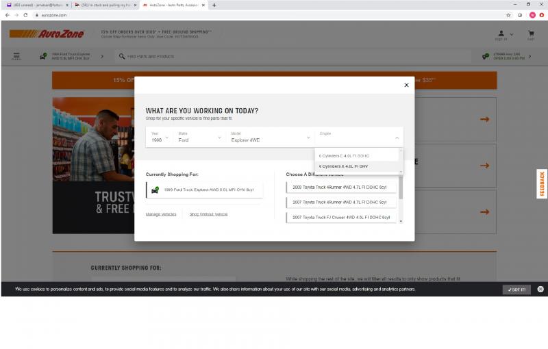

thanks for that i got the one for a ford ranger and it fits and auto zone and o riley's auto parts don't really give me that choice they keep telling me that the parts for the sohc fit . not sure if i should keep going or not i have it half way put back together , tx heat only gives me a few hours in the morning to work on it . and thanks again for that
FYI Autozone and Oreillys do give you the choice, when you put in 98 explorer tell them 4.0 OHV..........
there were two 4.0 V6 engines OHV and SOHC....so go ahead and reach past the 6 foot social distancing barrier and smack the back of the head on the Autozone employee
You can show them on their own website where it gives you the choice between SOHC and OHV 4.0
The SOHC INTAKES are way different then the ohv...
98 ranger will work as in 98 the ranger only had the ohv
