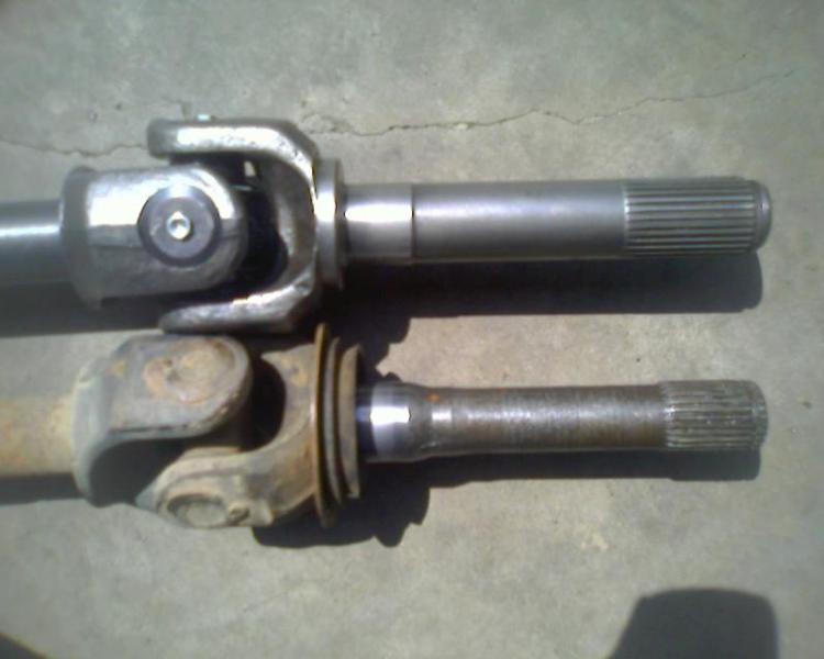

Here is a picture of the shaft difference from the 19 spline to the 30 spline.
That looks like a 27 spline stub, not 19 :confused:
(guess it still would be pretty close in size though)
