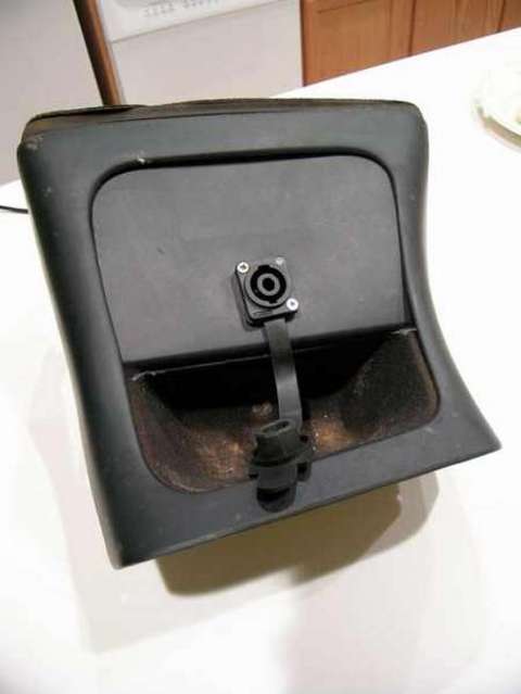

Installed the solenoid box into the little tray thingy under the dash. The winch remote plugs into the receptacle.
I'm amazed you still have this little tray thingy...or I'm probably assuming that was on the old setup.

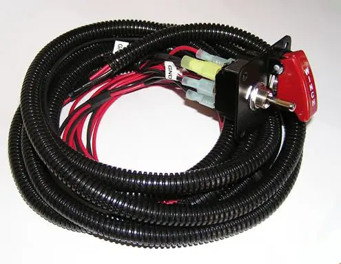

Posted elsewhere before, but an option - - you'd need to consider a different location unless you've got a rare manual T-case or do the Atlas II (or other t-case) conversion.
As Danny mentioned, good idea to keep the external plug for re-spooling...

Where did you get the mounting plate with switches? I'm going to leave the remote on the winch also.
Roadless Gear.com
www.roadlessgear.com
