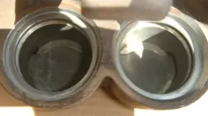

DON'T touch the brake pedal with the caliper disconnected, otherwise the piston(s) may pop out. The bleeders should be opened when compressing the pistons to change pads, otherwise you are forcing contaminants back through the system. If the guide pins had rust, they may be pitted and should be replaced with cheap replacement kits. Use specific high temp brake caliper lube or Syl Glyde, not anti seize or chassis grease which will gum up and bind quickly. Buy a quart of Valvoline DOT 3/4 brake fluid for under $10 and do a complete flush. This is what may remain in the bores, even after flushing. Open the bleeders and force that junk out.
