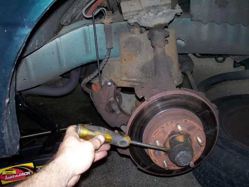

To begin, jack up the side of the vehicle, and remove a wheel. You will see the brake caliper, spindle, rotor, and grease cap. The following photo shows my 1995 Aerostar with a 2WD configuration. The caliper is removed, and supported in place. I have a large "S" hook in the following photo:
