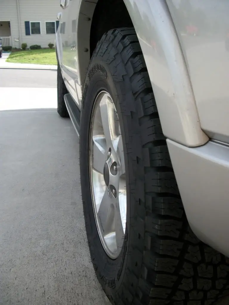

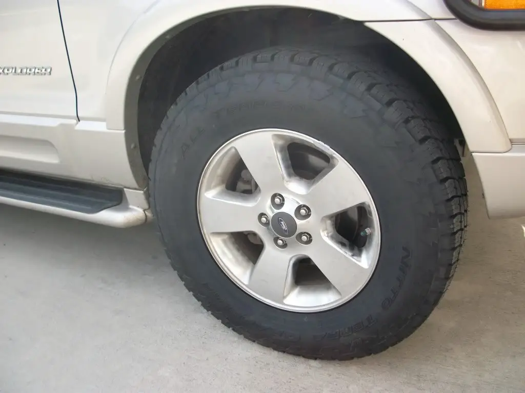

Hey guys, just wanted to put up some before and after, and install pics of my body lift and my new 265/70/17 Nitto Terra Grapplers. I also bought a yakima rack off ebay and put that up the same day as the lift..
Before lift w/ new tires installed

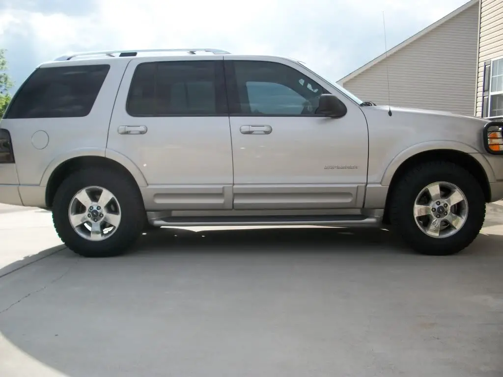

After lift w/ new tires
Here are some of the pictures of the tires..

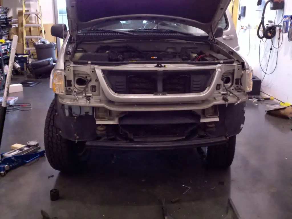

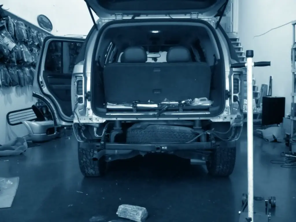

now the install..
It took me and a friend a little under seven hours to do it. Instead of using the bolts that came with the kit, we went down to a fastener supply store and got the same length and grade up threaded all the way down. by using those bolts we just torqued them down and didnt need the nuts and washers. We also flipped the bumper upside down and reinstalled (thanks for that idea explorer forum). That was pretty much it for the major changes, everything else was pretty standard. I didnt take many pictures of the install but heres a few..
Sorry about no side shots but the garage was to narrow to get a good shot with my phone. Anyway, I'm extremely happy with it! Looks a ton more aggressive with the tires and lift! I got my HID off road lights in the mail yesterday so I'm trying to get them installed on my roof basket before I leave for Afghanistan in may. I'm looking for some mounting brackets or clamps for a Yakima rack (I think its 1.25in tubing) so if anyone has any info or tips I'd appreciate it!

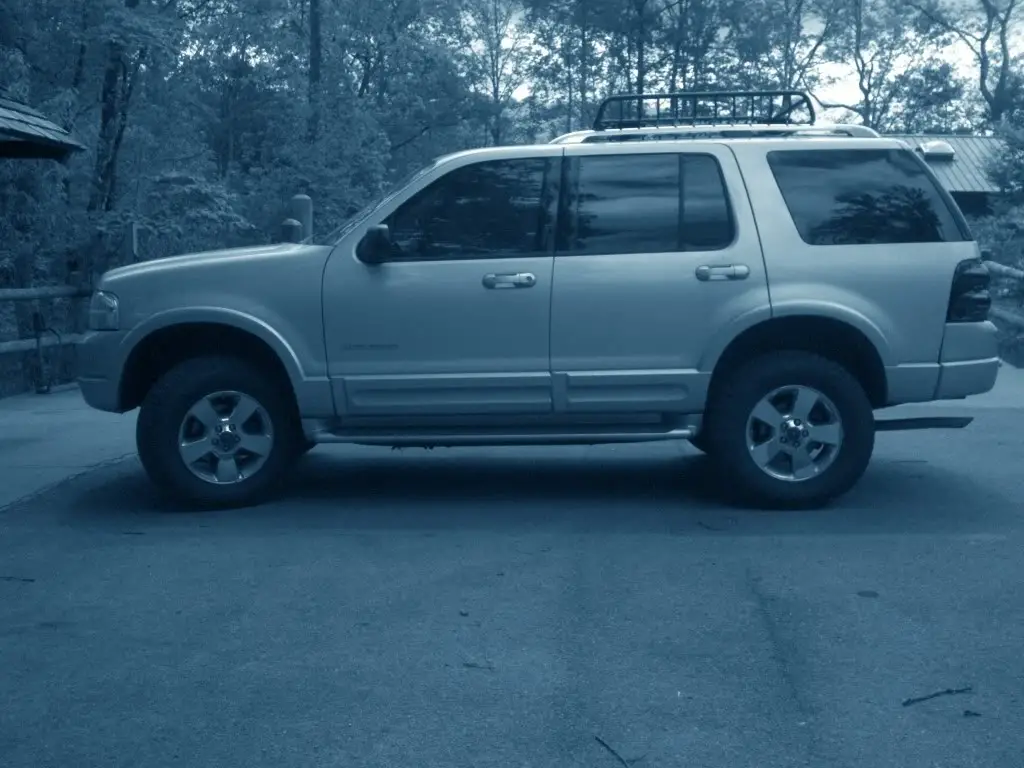

Heres one last one from yesterday up in the Smokey mountains enjoy :thumbsup:
