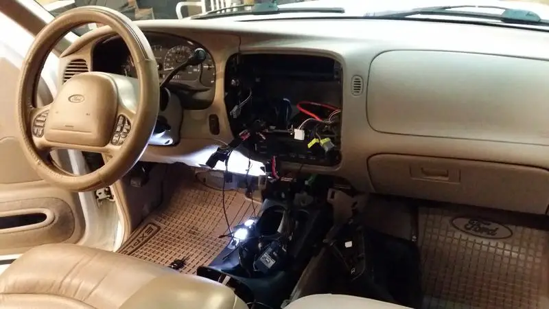

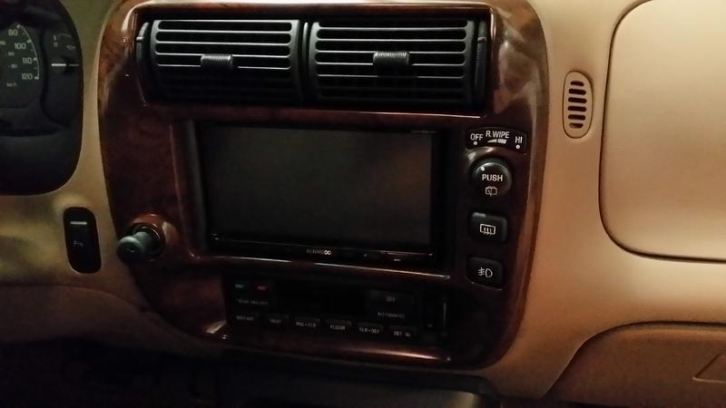

Well decided to go ahead and replace the head unit in my 2000 Limited with Mach Audio with a New 7 inch Kenwood Excelon DDX9902S TouchScreen with Apple Car Play and Android Auto.
Install was very straight forward. Both steering wheel controls and rear console controls work with no issues.
Supports full mirroring on my android phone device along with Android Auto and Apple Car Play on my iPhone.
So far it is a great setup.

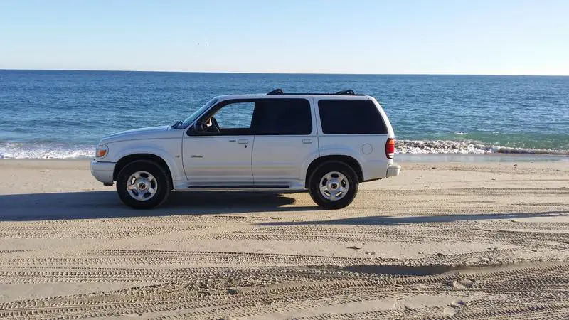

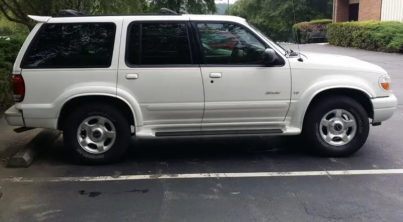

Here is a before and after shot after some of my recent work.
