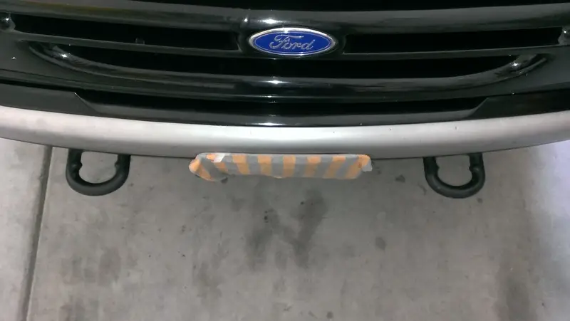

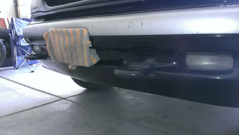

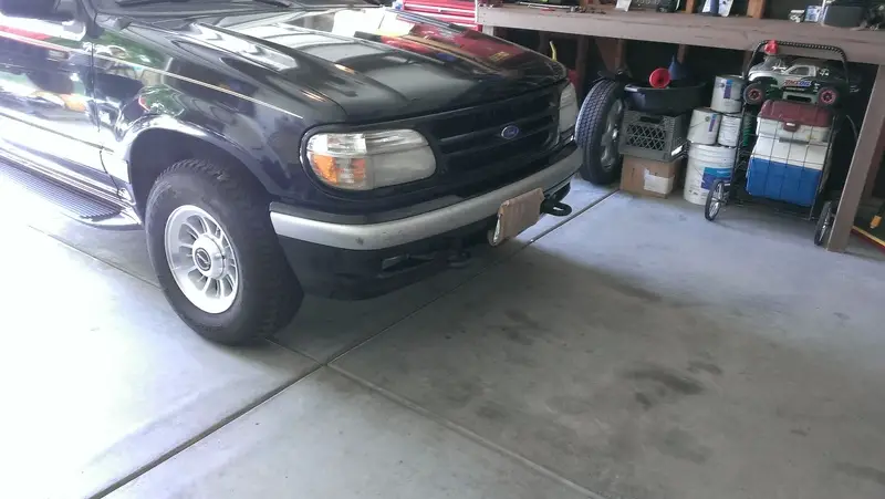

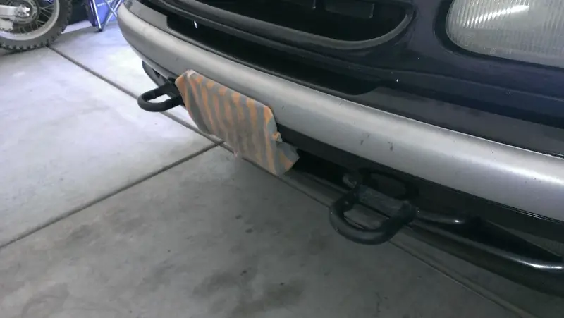

Ok so I grabbed 2 factory hooks off of a 2001 expedition and installed them on my Explorer. It was very easy. Drilled 1 hole and use the other existing hole on my frame and it worked perfectly. Did a little cutting on my bumper with a razor blade knife and bam that's it guys. What do you think?

Bumper comes right off with 4 bolts size 18mm. I bought some fresh cobalt steel drill bits (dewalt) to go threw my frame.
