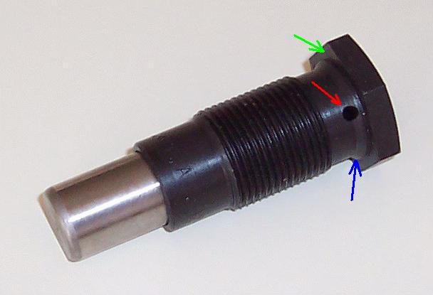

Thickness of compression ring
I wouldnt use any sealant on anything. I think it is VERY critical to use the proper socket and the CORRECT torue spec. The reason i think is becuase the tensioner has an oil hole and it is critical that it lines up with the other oil hole. Maybe im wrong but just use the proper torque
The thickness of the compression ring is important because the oil port on the tensioner is very close to the inner sealing face of the hex head as shown below.
The actual orientation of the port is not important because the housing diameter between the sealing face and the threads is reduced enough that oil can flow to the port indepenedent of the orientation.
oh ok. thanks for clarifying. i really wasnt sure. it just seemed like it made sense
