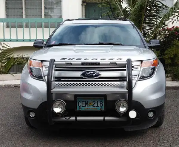

That one looks like it will also block the Collision Warning and Adaptive Cruise Control radar unit and front parking sensors if you have them.
The approximate location of the radar unit is shown by the white dot next to the right lamp.

Yes, this Sport is equipped with them. Is there something that needs to be electronically disabled when the guard is installed? otherwise, I would imagine it will constantly alert.
