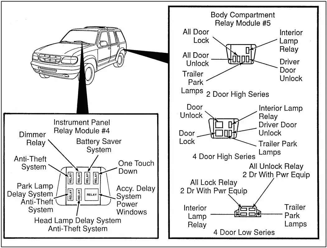

I would like to thank you. Your suggestion to change the relay under the dash on my 96 xlt, 5.0 was exactly what I needed to do. I have spent years dealing with my windows! They either all worked or not at all. I had pulled the door cards, looked for damaged wiring in the door jamb only to learn all I had to do was replace a freaking relay! It couldn't have been much easier. I took the old one with me to AutoZone and made sure the new old was a match. I was thinking on my way home how nice it will be to confidently use my windows. I plugged that relay in and Bada Boom, it worked! Also there is indeed a diagram showing the relays in the owners manual on page 391. I had not seen that little box with the relays before, but I won't forget it.
I'll be darned... I think they removed that diagram from latter model years' manuals, or at least I never saw it in a manual. One hint that it's the relay instead of a power or ground wire to the door panel switches, is the accessory delay relay controls more than just windows (at least in later model years it does) so more features would be inoperable than just windows. I forget which (besides some interior lights maybe?) but once you find them, can trace that on a wiring diagram.
Do you mean the O2 sensor is hard to access on the vehicle, or you can't find a source to buy a replacement?
^^^^^^^ Good Stuff! @J_C
