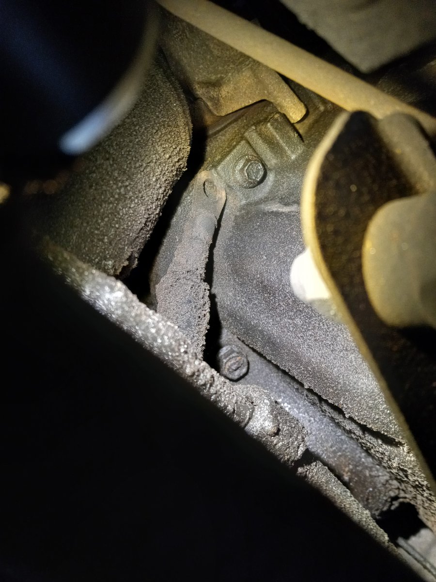

Well thankfully I found what the problem was with the help of this forum. It looks as if the previous owner had a repair done and the ground wire was never reconnected.
Yeah that ground is just kinda important lol
There are only 3 connections from the - side if the battery one to the frame one to the body and one to the engine
The frame and engine ground are sometimes the same wire
Without the big ground hooked up everything on your truck is trying to find a ground through the one small
Lead to the body…. Not good! Can cause a fire
Glad you found it,
Make sure it’s all clean when you re connect

Yes, thank you, I used a brass wire brush to get all that debris off.
