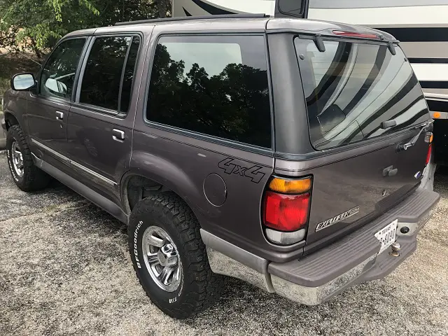

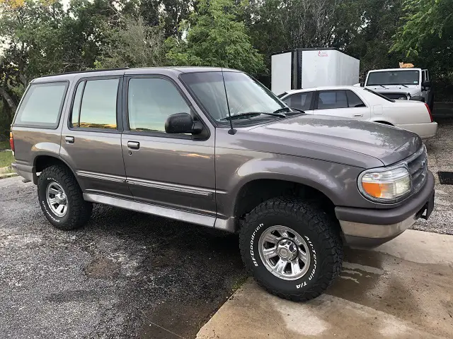

Sounds like a cool project. My son actually went from a Wrangler to an Explorer and he says that it's so much nicer as a daily driver.
We did a TT in the front and shackles in the rear. Installed 31x10.50R15 tires on stock wheels. We could fit 33"s if we wanted too do some fender trimming. We are west of you over in Kerrville.

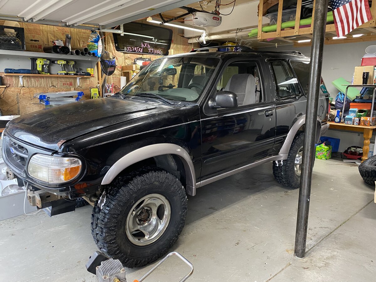

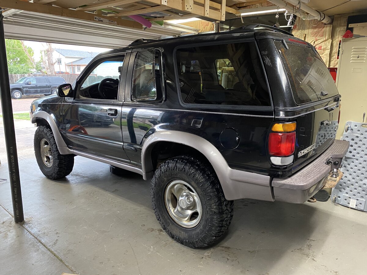

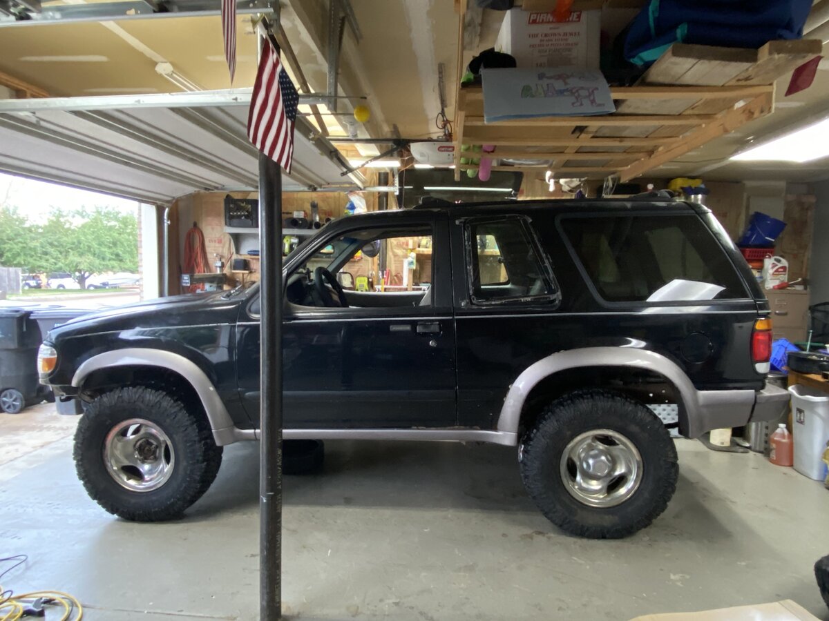

Look forward to seeing your Explorer and her build. On Mine I have 285/75r16's. I have 3" keys up front and I did a Spring over axle in the rear. Here is what Mine looks like now.

That's a nice looking truck! I have no doubt it's a more comfortable daily driver. Is it 2x4 or 4x4? What size shackle did you use?
Look forward to seeing your Explorer and her build. On Mine I have 285/75r16's. I have 3" keys up front and I did a Spring over axle in the rear. Here is what Mine looks like now.View attachment 339980View attachment 339981View attachment 339982
This looks awesome--it's about the same ride height I'm going for. Is yours also 2wd? monoleaf? How complicated was the SOA? Seems like most folk go the shackle route. Learning the site better--did you do a build page?

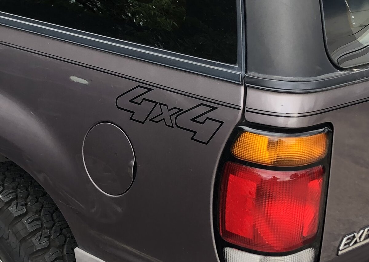

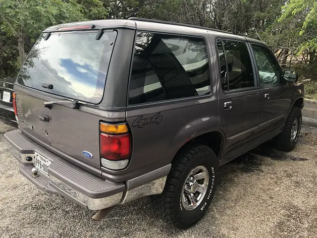

It's a 4x4... just added some 4x4 decals the other day. The rear shackles are 1.5" lift. We cranked the torsion bars all the way and then backed them off 2 full turns... also for about 1.5" of lift.
