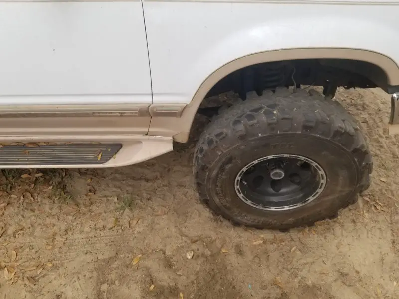

You called it. Iwas able to get Eddie's lift on last fri. when it came. Just a little trim to the front of the stock runningboard and she was good to go. I do have aftermarket metal tubestyle made to fit runningboards. Ijust really like the stock look and the little trim with sawsall is hardly noticeable. I have pics to post as soon as i figure how to post them.

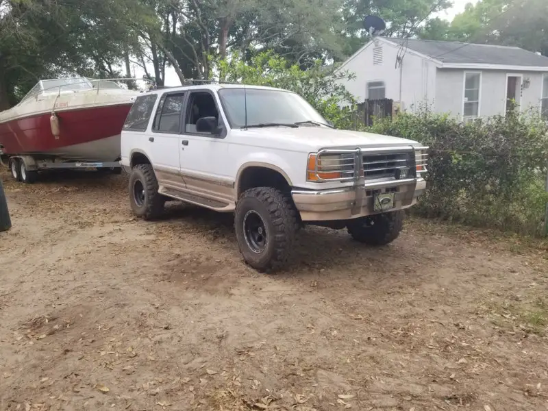

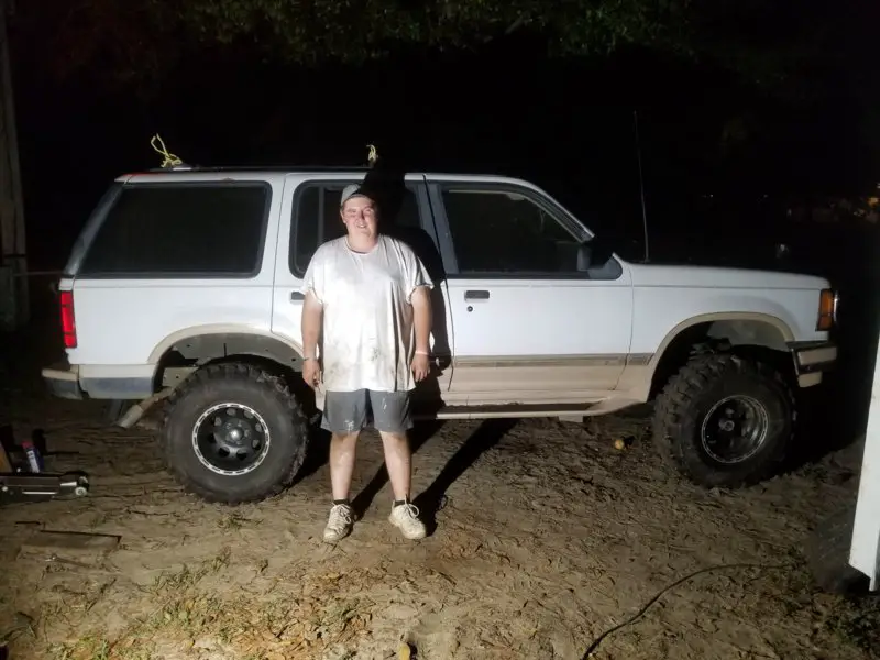

Here's some pics of my explorer now and that's my son in one of them

Looks great! What’s the tires, SSR’s?

Thanks. They are 34's super swaps 10.5s. I believe the rims have an outset which really works on Eddie. Still have a ways to go with interior. Scared to check what recovering Eddie's leather lumbar seats will run.
