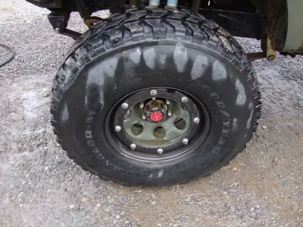

Here's the double beadlocks I'm hoping to get but they might be gone before I can get the funds together, six of these for $1k.
Patrick, I would feel more comfortable doing the trails at Raushe Creek with a solid axle over the IFS. Once I get it installed and get my gas tank skid plate done I'll be more then willing to go out there for a trail run.
