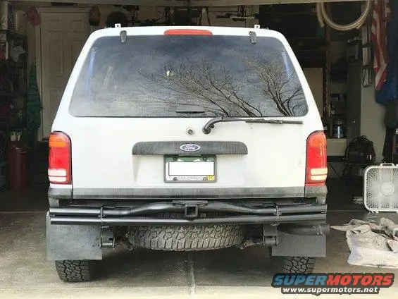

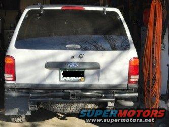

I am hoping to reduce the blow back on the rear window. The road gunk/dirt/snow/magnesium chloride builds fast and makes a mess of the rear of the vehicle. Getting gear in and out can be a challenge to stay clean and perhaps the rear window will stay cleaner longer. Anyone know of a good rear window deflector???
I added to the road gunk by cutting the rear quarters up and removing the bumper. I still need to complete my custom bumper by adding two more end pieces...............another day. The road gunk has been building-up faster on my rig as the stock bumper used to catch a good deal of it.

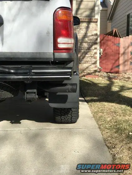

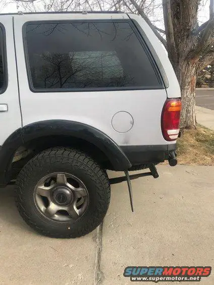

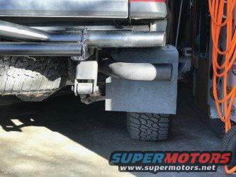

I used an old bed frame for the thin angle iron to make "L" mounts and got me some mud flaps from Napa. I welded one leg of the L to the body/inner fender and ran a bolt through the outer fender and mount. I wanted them spaced back from the fender opening slightly for tire clearance, not so long that they could get wound-up by the tire in reverse, and wanted them in front of the exhaust pipe.
Snow is coming and I may get up in the Mtns. tomorrow and get to see how much they help.
