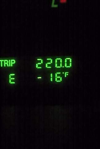

I have the temperature and the a compass on my dash from the factory but no message center

I had the temp and compass on mine but no message center either.

I also have the temp & compass readout without the message center:
Here is the thread for changing the temp sensor. It might help you determine if you have the sensor or the connector.
Hope this helps out! :biggthump
