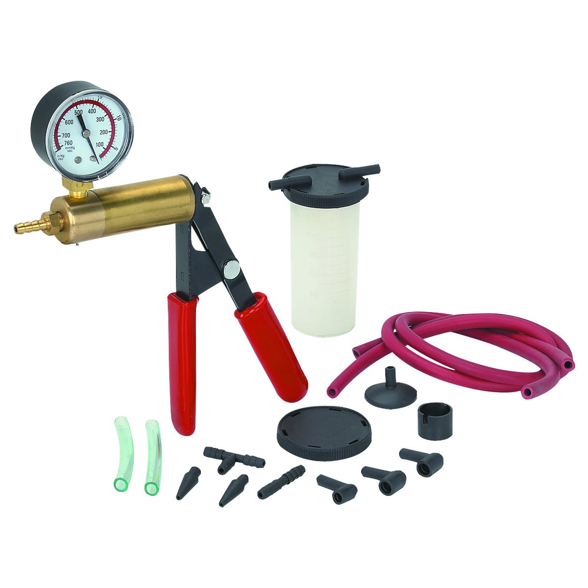

Fast, simple and proven method to bleed air from your Ford P/S Pump & Steering Rack.
1) Go to Harbor Freight and buy one of these:
2) Go to your local hardware store, and buy a rubber stopper that will fit (but not get sucked into)
your power steering fluid pump's filler neck.
3) While at Harbor Freight or your local Hardware Store, buy a barbed brass air line connector
that will go completely through the rubber stopper.
* Drill a hole through all the way through the center of the rubber stopper, and insert the barbed brass air line connector.
* Connect one end of the vacuum pump air line to the barbed brass connector, and the other end straight to the Vacuum Pump.
* Remover power steering pump cover/dipstick, make sure your p/s fluid level is full, and insert the rubber stopper into the neck of the pump.
* Start the engine, pump up to about 12 - 14 inches of vacuum on the vacuum pump,
and then turn the steering wheel full lock left/full lock right while watching the gauge on the vacuum pump.
* If air is present in your p/s fluid, you will see the needle drop on the vacuum pump, and you will hear a pleasant change in your p/s pump noise/groan.
* When you get the air out of your pump & rack, the shuddering effect will stop.
* When you remove the rubber stopper, you will see little air bubbles on the top of your p/s fluid in the pump reservoir = SUCCESS!
* Through the years, you might have to do this once in a while if you sense p/s shuddering.
* NOTE: If you turn your steering wheel w/o the engine running, you can introduce air into your p/s system.
Hope that helps!
