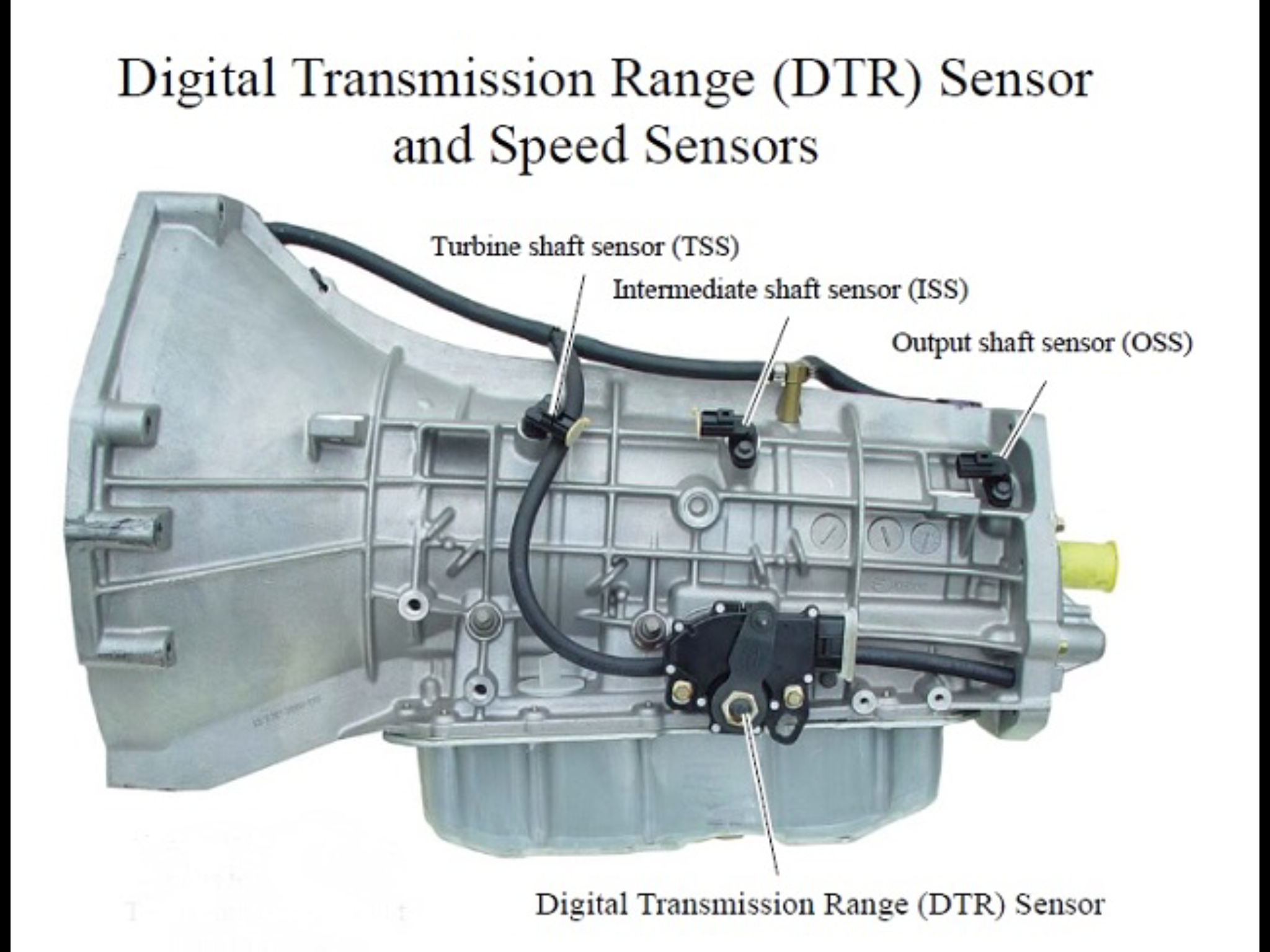

SOLVED: Tranny shop took one look at it and noticed the Neutral Safety switch was place backwards.
He took off the old bushing connector, replaced the connector, and aligned the cable the same way as mentioned by others above. Thank you for your help.

can you explain about drs being on backward. i am having same problem and can not get this figured out. i have even tried putting it on upside down
I wish I could. The trans shop did the work for us. I personally didn't do the work. I looked at the invoice and there is almost no description of the work performed. Sorry about the lack of response on this one. Transman304 might be able to shed more light on this.
It should look just like the one pictured.
ok thank you for replying
