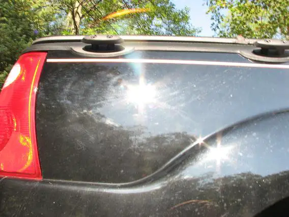

Technically, I moderate all detailing threads. And yet, I've not once shared my detailing "credentials." Well, I've spent the last four days buffing out the Trac--the first full buff since I got it three years ago. And, damn, it needed it. But, now I am happy I own black again. It looks so good when pristine. (Thus, when it rains on it, I will hate the color once again.) The process is below.

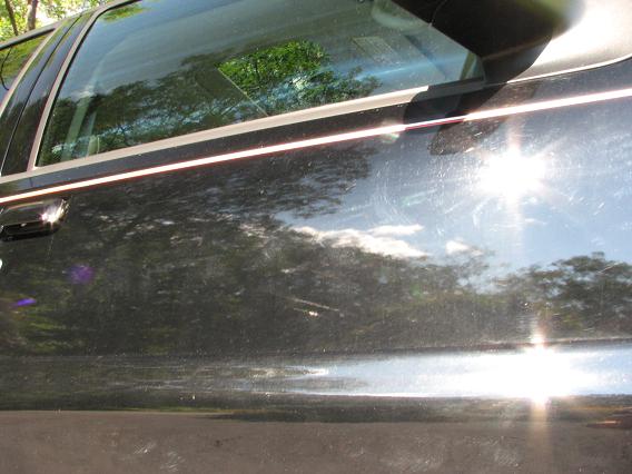

Before:
attachment.php
attachment.php
It's dirty there, but even washed, the swirl marks were horrendous. I have a garage at school, but no time to buff and the apartment lease clearly states "no car washing" in the garage. So, I would take it to a local detailer who did an okay job--except that he used filler, and not true cutting, polishes. Thus, after a few washes, all the swirls came back. When you want something done right, you do it yourself--because I am home for a little while, I broke out the Porter Cable and my cutting polishes. Well, I started on Saturday. I should be finished tomorrow (with the mop-up detailing). Here goes....

Thus, it took me four days to do the exterior. But, the proof is in the finish.

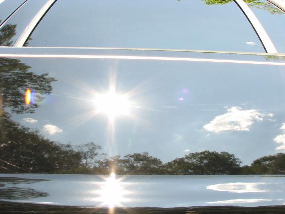

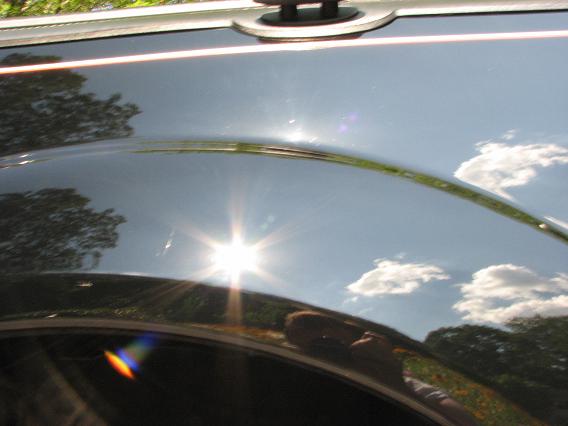

After:
attachment.php
attachment.php

The aftermath looks great. I may have to just do that to the explorer, it shines and can see yourself in the paint but it has a distorted look. Awesome job. Going to have to take notes for myself. :)

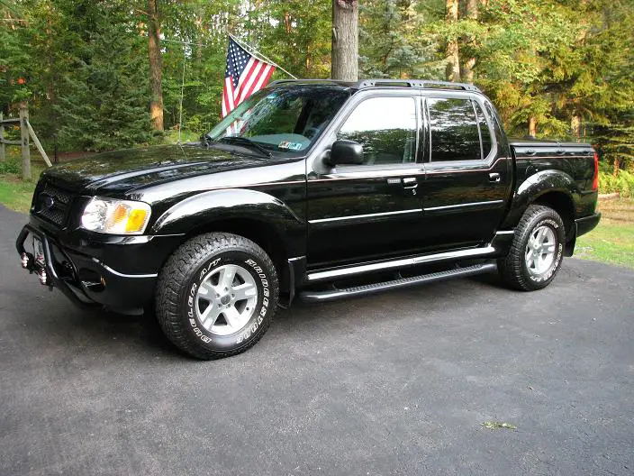

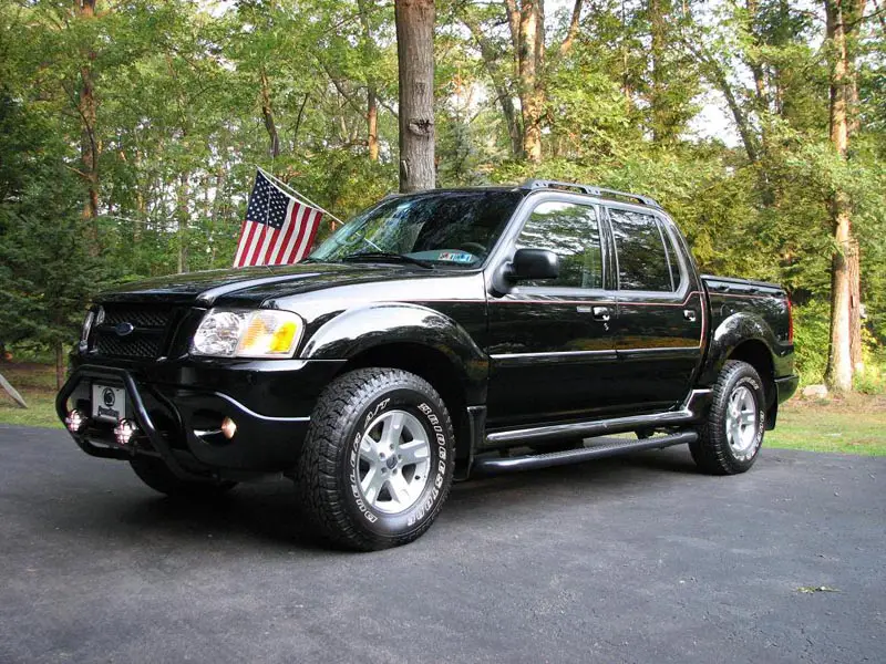

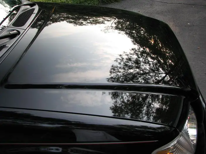

The sun set a bit, so I could not do a full sun-on shot of the finish. But, you can see the clarity above. Here's the final product.
attachment.php
attachment.php
attachment.php
I'm going to rest now (5 days total....).
Oh yeah, those are my 31.5's. Don't laugh, Jason. :D
