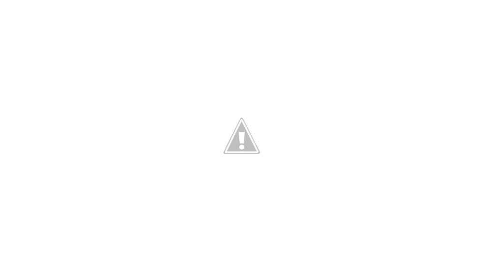

Well I finally got everything installed! And to whoever said it was a 3-5 hour install...you LIE!!!! hahaha, it ended up being a 5 hr job on Saturday and 6.5 hr on Sunday. I know it took some extra time to install the new tie rods, lower ball joints and UCA's but it def was not a super easy task (atleast for me). But after its all said and done I freaking love it and the new stance it has! With the new 265/75r-16 AT2's, it rides smooth and looks a little more like a truck but still be a good, reliable everyday drive. Enough talk, here are the pics....
Here are the height differences in the headlights and foglights...

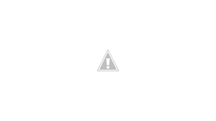

I have wired the fog lights to the side indicator light that is circled below:
so when I cut my headlights on, the side indicator also lights up, which also lights up the fog lights.
