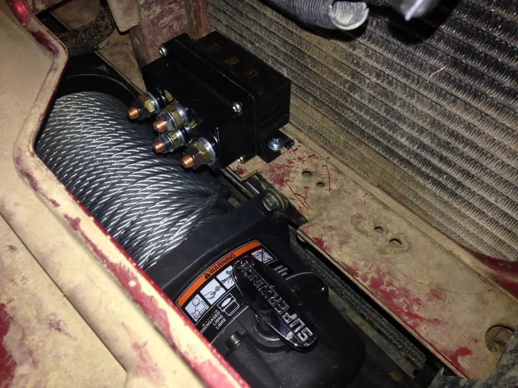

I have a Superwinch Tigershark 9.5. It's mounted behind the bumper between the frame rails.
I've used it 3 times. Once on a Jeep and twice to get myself out of the snow.
I originally thought I wanted the option of front and rear winches with a winch like Colin described. My front bumper has a receiver just for that reason. But then I decided that carrying around ~100 lbs of winch and receiver tray inside wasn't an option. And installing it while buried in whatever might not be an option. Yes it could always be installed on the front and bounce around, but it takes away from front clearance.
