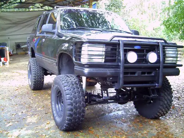

My name's Josh and I live in Dothan, Alabama. I've owned the truck since November, 2003. It's a 1992 Ford Explorer XLT 2WD. I started with basic upgrades and modifications like new paint, clear corners, tires, and wheels. It then turned into a constant work in progress resulting in what it is now.

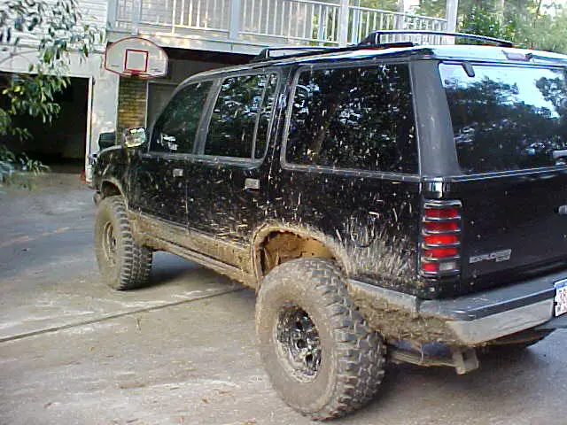

Some muddy ones
Another trip (With my buddy's Tacoma on 35's)

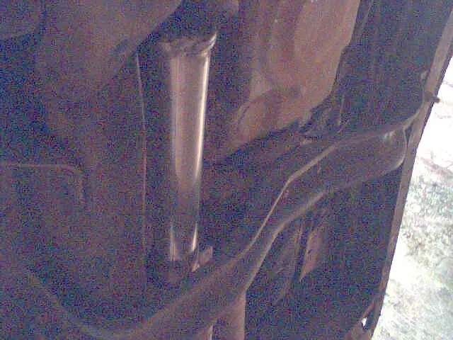

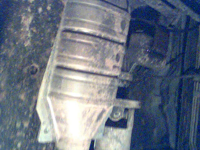

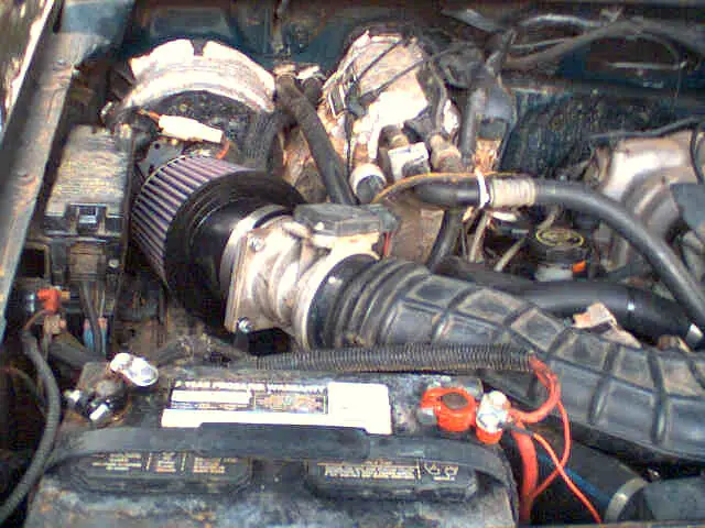

Updates: Got my Christmas presents put on. KKM, and Maganaflow high flow cat. Had a pipe put in place of the first cat and the high flow welded in place of the second. Added a tad bit of HP and sounds great. Very close to a V8. Here's some pics(excuse the crappy quality, had to use my camera phone):
KKM installed
Maganflow cat
New pipe in place of first cat
Up next: 4.56 gears and a locker!

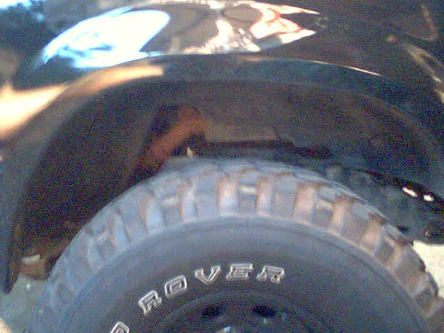

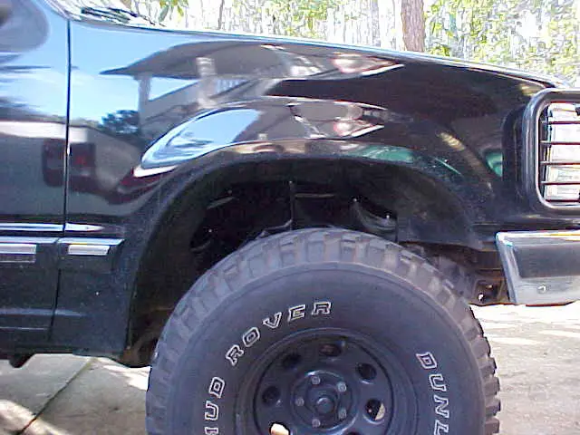

Well, it's update time again. Got a few more things done. First off, I made some gap guards for the front out of pond liner. I was sick of seeing exposed engine parts and wanted to keep mud and crap out of the engine bay. They turned out great and only cost $10.00 for a 12'x1' piece of pond liner. Cut it to size and used pop rivets to hold it to the fenderwell.
Before:
After:

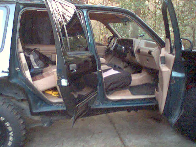

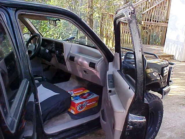

I had my truck painted black after I bought it, because the green paint which was on it was in terrible shape; faded, scratched and chipped. Well, when I had it painted, they wanted to charge me $75.00 per door to paint the door jambs. I said no way! So, I finally got around to color matching them. I figured the easiest option was Herculiner, since I could brush it on and not have to mask off as much area since there was no spray. Also, it would provide a durable and solid step for entry into the vehicle. But basically all I was going for was to match the door jambs to the body color. Looks pretty sick, just need to do a few touch-ups.
Before:
After:

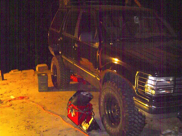

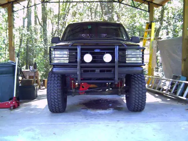

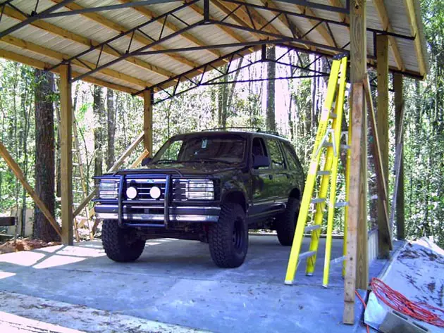

Well, me and the old man have been working like crazy the past few days. We finished the carport so my truck will have a place to stay while we work on it. Here it is in the carport; a "before" picture, if you will.

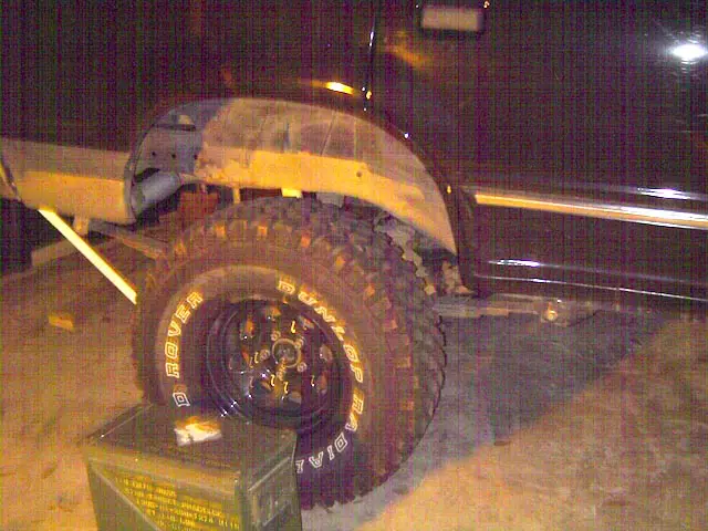

So on to the first project! The first thing on the list was to rip out the body lift and get ready for the suspension. We finished it up yesterday. Yeah, that's right *****es, 2" of lift and 33's! woot!
I think I might have some rubbing issues :D

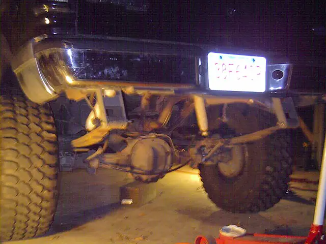

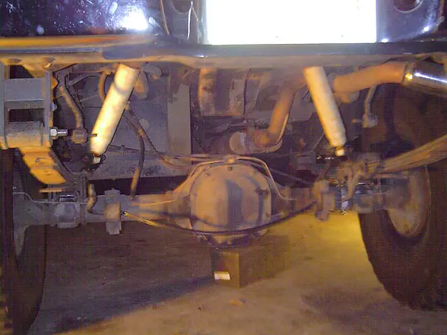

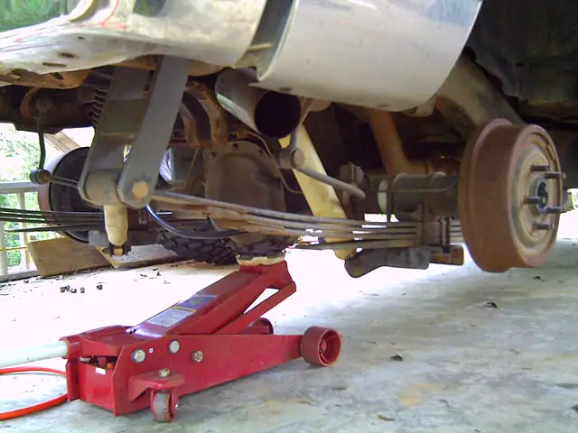

Now for the Spring Over Axle! We actually finished this in half a day. We're usually extremely slow and hardly ever finish a "bigger" project in one day. Here's a before pic of the stock SUA:
And now the kickass SOA! With the shackles, I estimate it at about 7.5" of lift. It's got a wicked rake.
As soon as the Skyjacker parts come in, we'll start on that.

Thanks Bryan. If you look at the pics, there is no way that sway bar is going to work. It's about 6" from connecting up. I'm either going to make extensions for the endlinks or trash it altogether. Just hafta to see how it drives (I really don't wanna flip this thing :p ).
