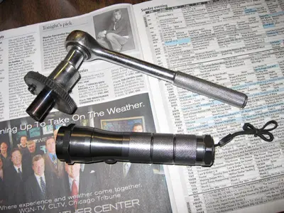

KD9OWX
remove the motor, throw it on a hard surface(driveway or sidewalk works well) and take the metal gear out.... then all you have to do is reach under and engage 4wd by hand. thats what i do. no electrics, and alot cheaper than getting a manual case around here. sometimes you have to push a tire with your foot to rock the truck a little bit and then, "click"... you'll feel it go.
don't be dumb like me and weld the socket on backwards. but i dont even use the ratchet anyway. its easy enough to do it by hand and not hassle with a wrench.
I dont have that big bulky harmonic balancer thing on anymore either and i cant tell a difference. I think you have to remove it to get to the motor, and i was just to lazy to put mine back on.

hahaha whatever works, I have seen alot of manual shift e shift t cases to date, all of them use a different method
