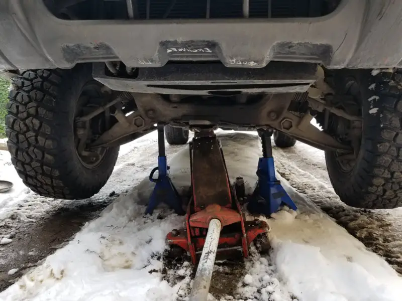

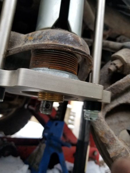

I have jack stand (one functional and one with missing upper part). Sometimes I don't use them, but as soon, as I de attach the wheel(s), I put it/them under the cars frame. I will not work from under the car. I'll access the balljoints from the side. I have purchased a ball joint replacement press. I can borrow a heavy duty hydraulic jack from my neighbor, but it's too HD and maybe jacking side by side with the stock jack will be easier for me, than transporting the DH hydraulic jack from my neighbor.

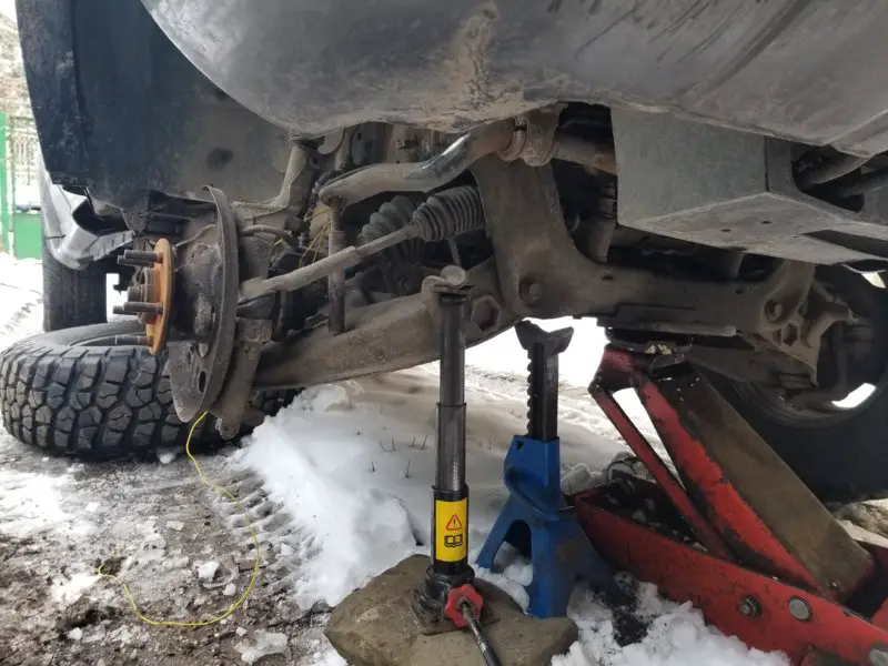

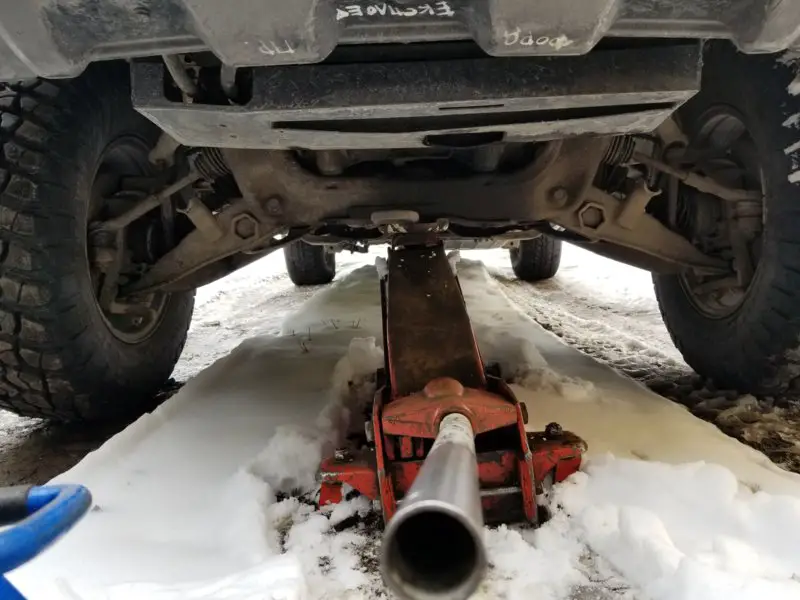

1st try was a fail. The jack just sink in the wet ground. Then I put a plate under the jack and lifted the Explorer on the crossbeam. It was useless, because as the suspension expand, it put on tension my upper control arm, which I wonted to replace and the half axles. Then I decided to use the stock jack too and moved the most of the weight on the jackpoint on the lower control arm. The repair was successful. Now I am waiting for my new custom shocks to be manufactured and then I'll replace the swaybar rods and install the new shocks.
I would have probably put a flat piece of wood or a large brick under those jack stands. It already looks like its tipping to one side because of the uneven snow and mud under it.

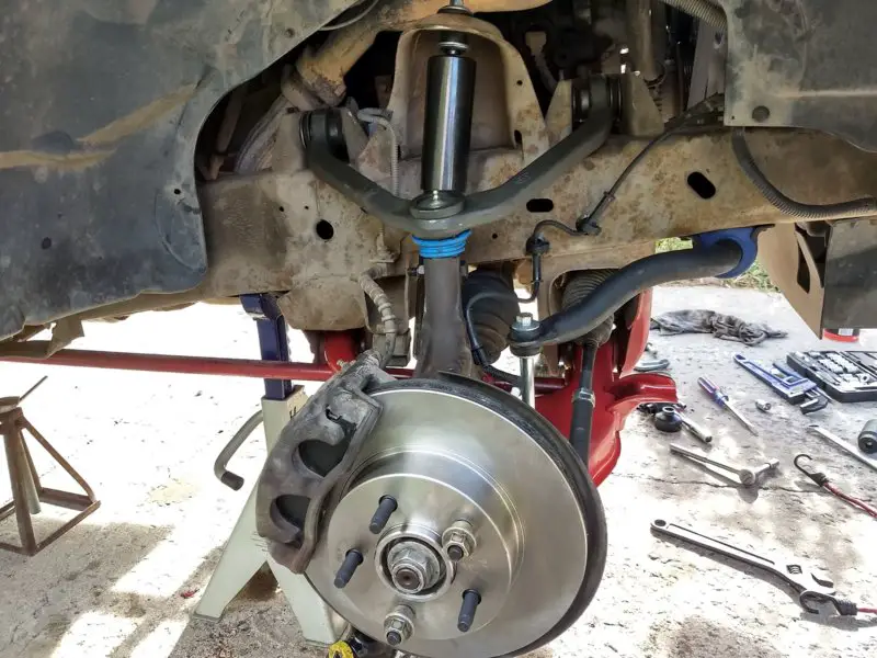

I put the stands on the frame behind the front TTB assembly to allow each side to be lowered to work on. A whole lot safer and it gives more room to work on things.

That’s a much better placement.

I always use 6 ton jack stands on the frame behind the front TTB which is what Ford recommends. I also use a 3 ton quick lift floor jack under the control arm in front of the ball joint. Never had a problem. I keep a 12"x12"x3/8" thick piece of metal in the truck in case I'm in the middle of nowhere and need to use the stock bottle jack. I'm not for cutting corners either, I've learned that the hard way a few times.
