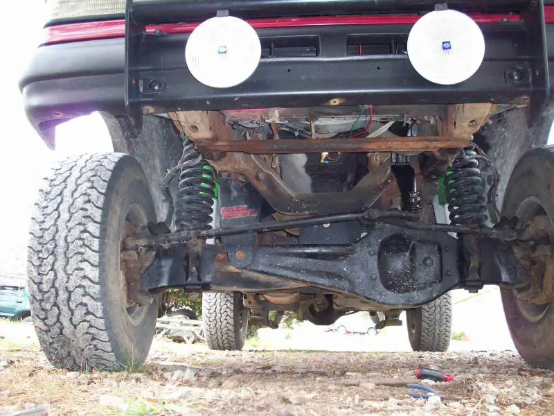

Those springs were stiff.. I took it for an alignment and they said I needed drop brackets before they could align it. Dissappointed I drove home, with horrible camber. Thats when it hit me.. If I need to buy drop brackets I might as well buy a 4" lift, and some shocks, and a pitman arm, and some AALs and get some 4dr leaf packs from the salvage yard and.. well you get the idea.
As you can see.. everything held together during the first 'test run' of the new suspension.

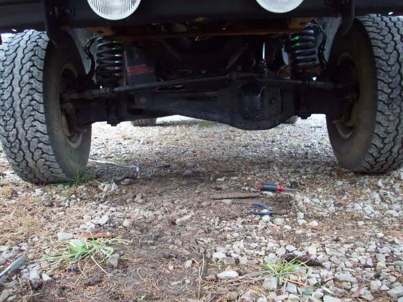

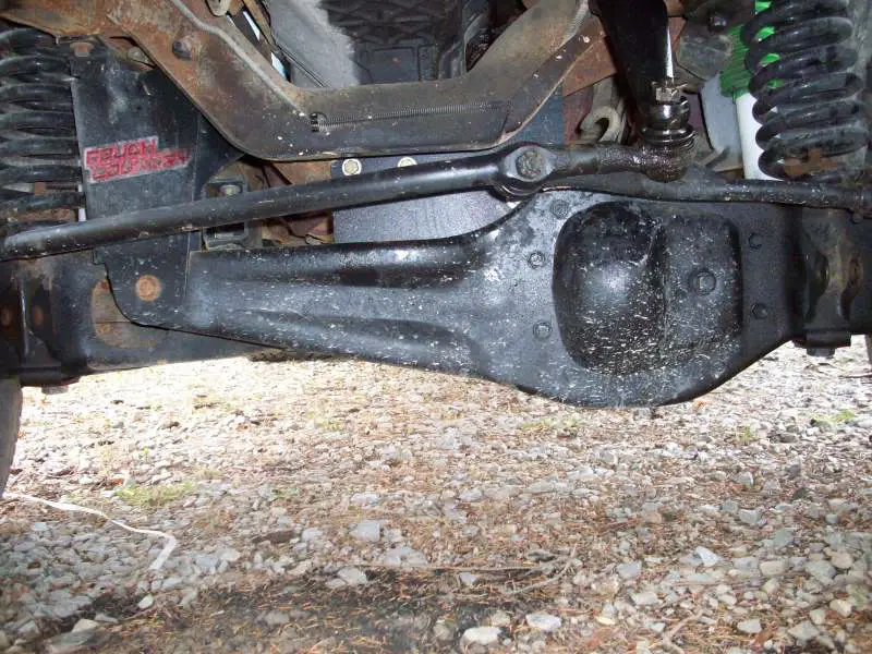

i had another boring day off last friday, and the weather was decently warm so i thought id mess around with the truck a little bit. a friend advised that i might actually benefit from taking my front sway bar off, not just flex wise, but driving wise as i still had stock length links on and the sway bar was pretty tight, so off it came. while i was at it i took off the lower bumper valance, for the ever popular 'my truck looks 2 inches higher' look. heres what it ended up looking like.

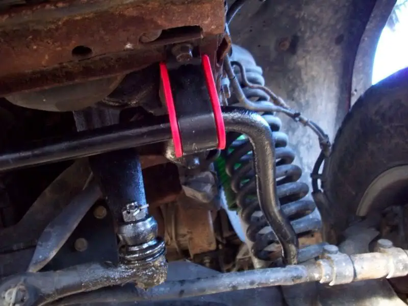

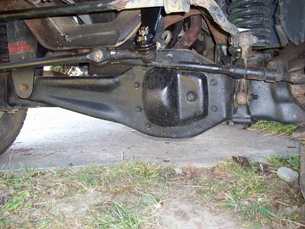

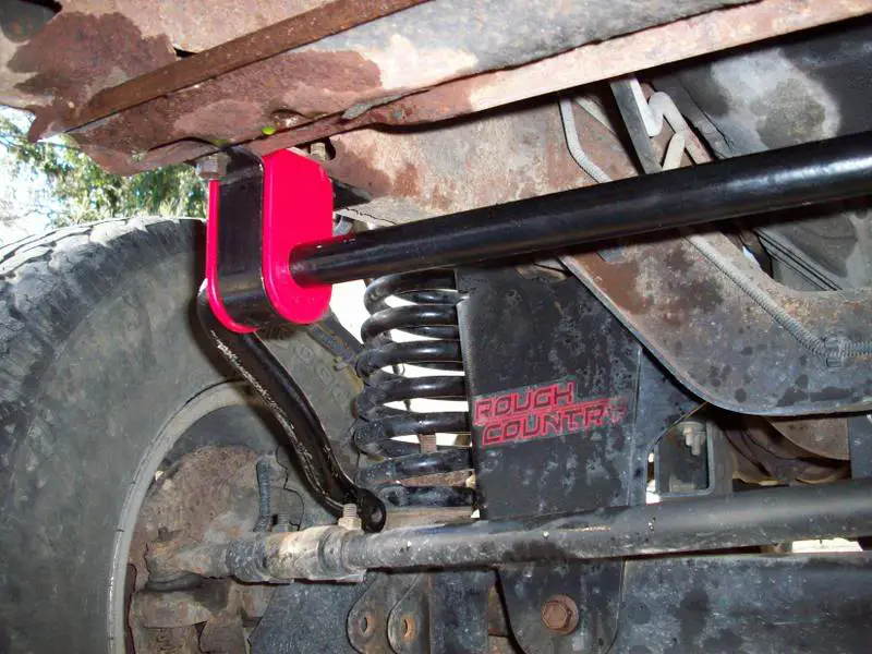

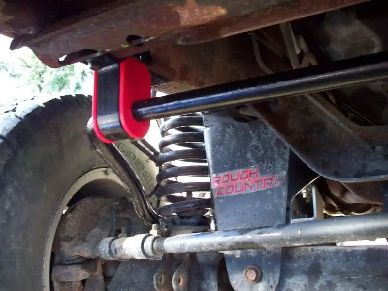

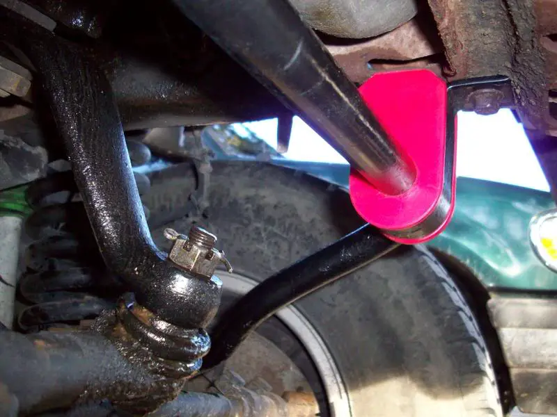

one of the gifts i got myself for christmas was an energysuspension sway bar bushing kit, i am currently in the process of extending my end links (procrastinating) but i did manage to wire brush my sway bar and bushing brackets, put on a few coats of gloss black, and install the energy bar bushings. here are a few pics of the progress so far
hope to get the end links done soon and take it out to see how much the longer links and new bushings help.
yes that is antifreeze drips you see on the pass side of the core support. the top of my right tank leaks and whenever i top everything off it slowly seaps back out to below the leak then stops. its a 15 yr old truck.. what do ya expect.
while I was under there putting the bar back on i noticed a good bit of ps fluid around the bottom of the gear box and on the pitman arm. last week during some single digit weather my ps was whining and making a noise while making low speed turns. next morning i went out to see that the fluid was low, topped it off and its been fine ever since. noise has gone away, and the level hasnt dropped any. i couldnt see any lines leaking, or any spray around the pump. i reached my hand around the bottom of the resovoir and felt some fluid.. maybe the old fluid got thick with the cold temps and was forced out of the jug? idk, so far everything is ok. when it warms up i will degrease the gear box and pump to see if i can find a leak.
