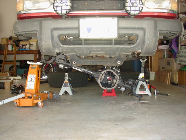

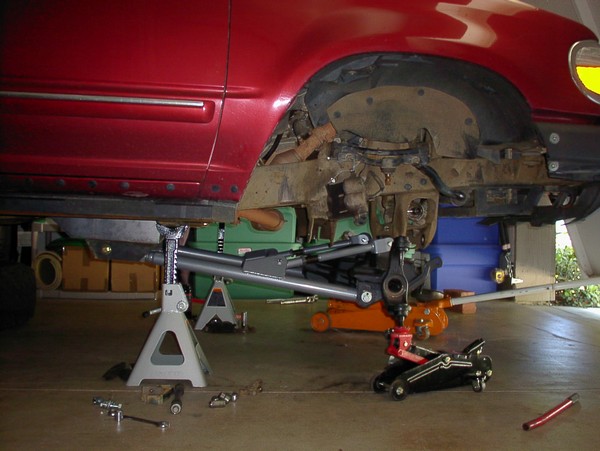

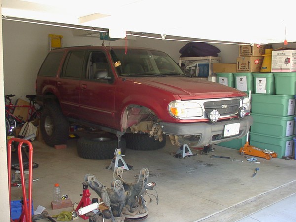

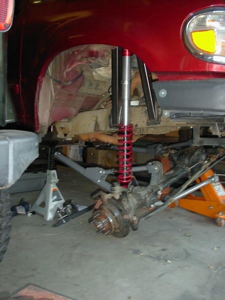

Suspension / Lift
Front:
SAS (Solid Axle Swap):
Rubicon Express Long Arms for TJ's
Custom D44 (Dana 44) front axle:
-High Pinion
-TJ width (~2" wider than stock explorer)
-TJ brackets
-Chevy outers; 11" disk brakes, Warn premium hubs,
5x5.5 bolt pattern
Sway-a-way RaceRunner coil-overs:
-2" reservoir, 14" travel shock
-dual rate Eibach springs; 250, 300
'94 Explorer steering gear box
-hybrid steering shaft
Custom steering links
-1 1/2" .250 Chromoly
-3/4" heims
SAS Build-up Thread

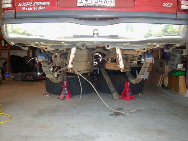

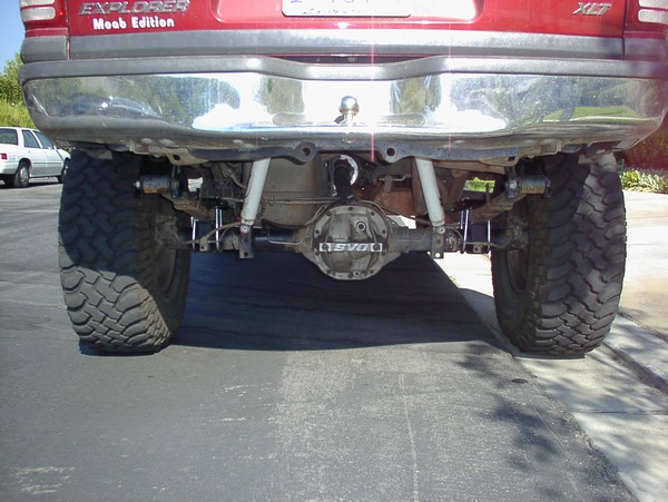

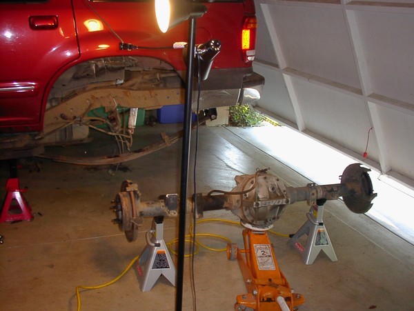

Rear:
SOA (Spring over Axle)
Deaver Leaf Springs (Custom)
Warrior lift shackle
M.O.R.E. wheel spacers:
-1" spacer
-5x4.5 to 5x5.5 conversion
Rancho RS-9000X shocks
