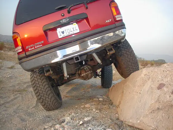

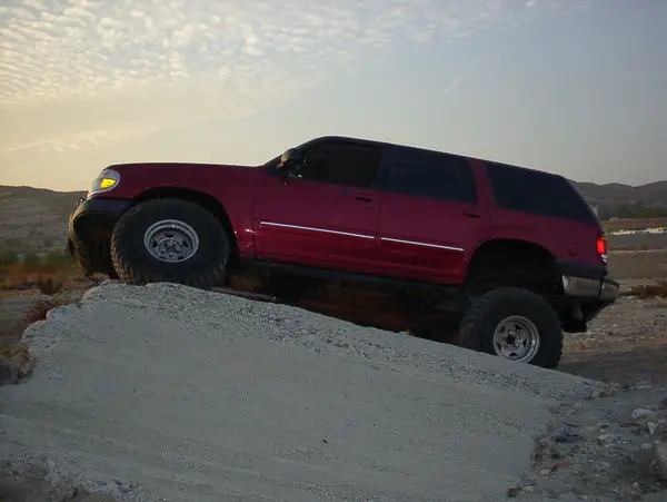

Ran out of ramp :D

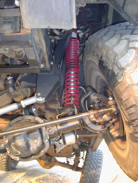

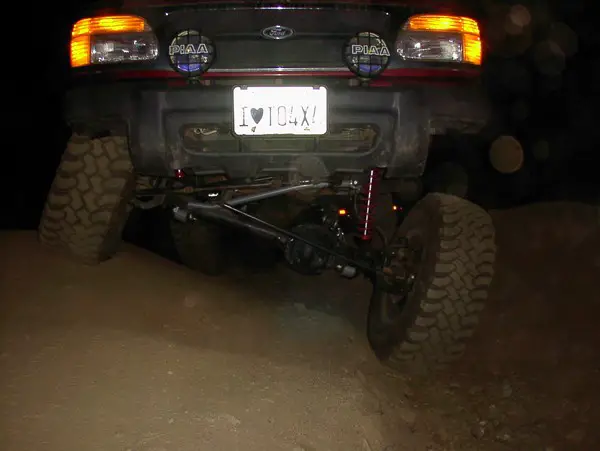

Good shot of my track bar bracket
Control arm mounts (I've figured out how to redo them and get 3-4" more clearance. just have to be brave enough to cut out the stock tranny crossmember. maybe in another few months)

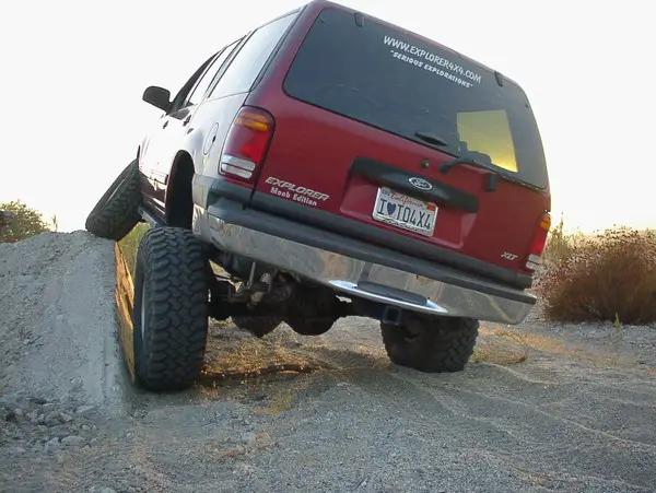

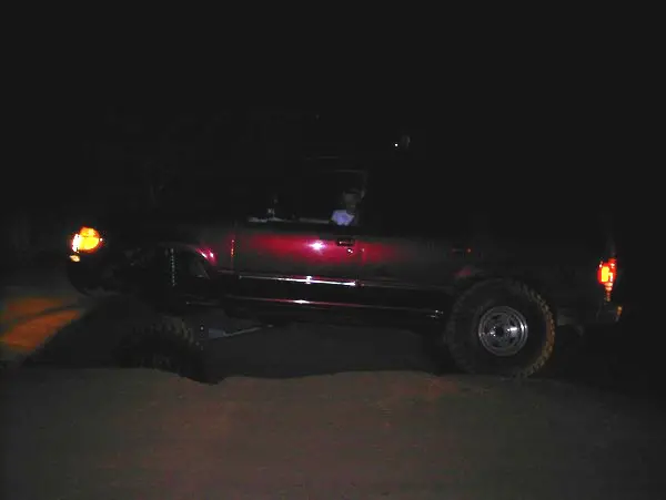

Going up backwards I stuffed the front tire too much so I couldn't continue without tearing up my fender well. Need to put in some bumpstops.

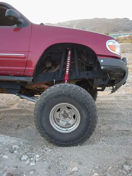

Thats pretty close to full droop

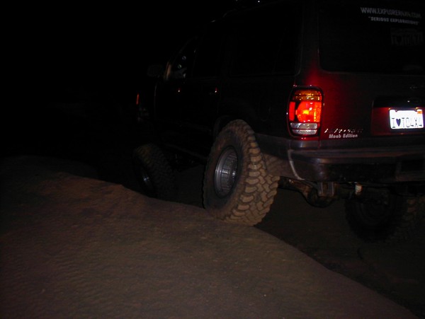

The rear flexed pretty well going forwards, but isn't doing a thing going backwards :rolleyes:

Did it pop and crack and make noises while you were going up the ramp??
How did it ride on the way to the ramp?

on your track bar mount on the frame - in relationship to the pitman arm how close is it? it looks like you can clear the pumpkin and the pitman arm with your bracket ... ive had a time lining that up.

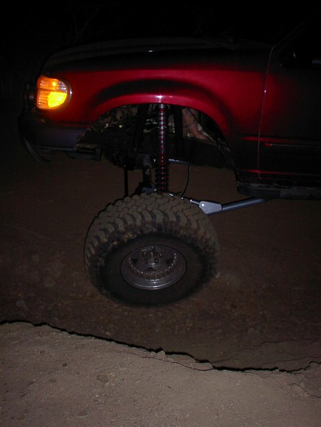

That is awsome!! Is your tire rubbing on the shock on that full stuff pic?? That is very cool, you did a great job.

That looks really nice! I bet the back will move once you put some bumpstops up front. It looks like the front is softer so it just uses up its travel first when you don't have a bunch of weight on the back. Great Job!
Mine does the same in the rear when you go up it backwards.
Fricken sweet!!!!!!!!!!! Looks great!!!!!!!!!!!
mine too... if there is something in counter front that it is also going up then the rear flexes something fearce. as in right front compressed right rear compressed...
isnt it cool having a front end that can flex as much or more than the rear? explorers flex more than most in the rear stock too.
Other than the dual rate coil-over squeak/scratch, as the center slides up the shock shaft, it was quiet. Offroad its great. I was expecting to have to revalve the coil-overs, but they're stiff enough for now. Definitly different than the IFS though.

track bar bracket is clear of the D30 diff (hopefully the D44 will clear also) and the pitman arm. however it is right above the tie rod, so if I stuffed both sides up within 1.5" of the future bumpstops, I'd pretzel the current tie-rod.
You going to Los Coyotes this month?
Yes, however with bumpstops that should be mostly avoided. And yes I should be out at Los Coyotes with my D44 ready to rock :)
yeah, with bumpstops it should help a lot.

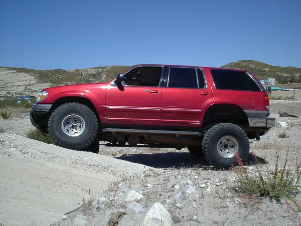

Jefe looking good:thumbsup: I admired your wood working skills when you built my storage box but you never cease to amaze me. You transfered your wood working skills to metal. That is really some piece of art.
Your rig will flex better in the rear when you get some multi-leave leaf springs. Mine did. The trick is to make front and rear work equally.

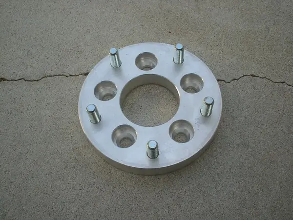

Got my MORE wheel spacers/adapters in; spacer is 7/8" thick to match the TJ width, and adapts from 5x4.5 to 5x5.5 to match the D44.
And went on a midnight run w/ John to test out our new suspensions. The front was great. The steering is much nicer than the rack/pinion offroad. I can actually turn even when all the weight is on one wheel. I had adjusted the dual coil stop, so that the 350 lb/in coil takes all the weight before i fully stuffed a tire, so thats doing a good job of acting as a bump stop. Got off the trail and did some baja'ing. Got up to 40-45 mph on a road with 6-8" whoops/gullies and the front handled great. Nice and smooth. much nicer than the IFS. Now my biggest problem is I can't find an obstacle/rock big enough to actually lift a tire on :D
