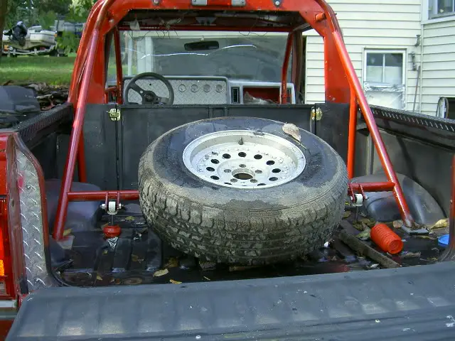

No it's for my chopped B11, So I'm looking for one similiar to Rangers. I allready have a full custom cage. I just posted that for other people to look at. Need tire carrier in bed. Flat
Like this. I just have tire laying there now. I was wondering how is the tire held down. I can fab up some bottom supports. But was wondering by what means is the tire held down. Does any one make the part that goes thru hub? Or do I just make it myself?
They make a spinner you can buy, its el cheapo too.. let me see what I can find....
as for the Jeg's cage, they are basically pre bent tubes, you pick the number of floor attaching points and then you can add braces to the frame from the floor. It's a cheap and easy way to get roll protection, I just want my cage up against the cab much tighter and plan to go behind my dash as well instead of into the door opening area.
Most simple designs for tire carriers are just crossbars X with either a threaded bolt you simply fit the tire over and tighten with a large nut, or some sort of tire mount fabricated to the center of the crossbars. The possibilities are really endless. Here are a few ideas...the first pic is my favorite because it allows for movement if you need to use the bed for anything. Also: go over to the dezertrangers forum and browse threw the fabrication forum there are tons of pics of different tire carriers.
Yes most companies make a tire mount you can buy...but if you have fab skills and a welder it would be just as easy for you to make one yourself. You'll pay at least $50 probably more at any of the fab shops for a well mand tire mount.
yeah what I am refering to to buy is just the backing plate with the threaded portion that goes through the wheel and then the spinner that threads onto it. ,making the base is up to you. This sucker is made for people who are racing and need a quick tire change, I have no issue on the trail with using wheel studs and a couple of lug nuts, though it may not look as cool :)
What ever works :thumbsup: Baseplate/w either bolts fed threw...or welded to and a few lug nuts and your set. I've even seen guys fab plates using an old rear hub assembly.
Thanks Guys. That's what I was looking for. I'll post some pics with the help you all gave me.
