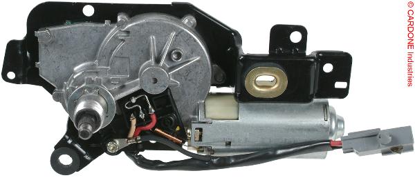

So my rear wiper motor had stopped working over a year ago, so I finally got around to replacing it. I first ordered one from Rock Auto but it turns out it was for a 4 door. It's unfortunate that a lot of the parts listed for the Sport are actually for the 4 door, this has happened a lot to me - their catalog is wrong or something, etc.
Anyway, I did some google researching and found the right one on ebay. This is the one I bought--- http://www.ebay.com/itm/261238813731?ssPageName=STRK:MEWNX:IT&_trksid=p3984.m1439.l2649
Super easy to swap out, works like charm. The part numbers are 2L24-17W400-AA , 3L2Z-17508-AC
Maybe this can help somebody else down the road if they are searching.
My question is - what should I do with the old motor? Anywhere they can be sent for refurb or whatever? Does anybody here want it?? Let me know if so :)
What's different between the sport and 4 door on the rear glass? Only thing I can think of is they are different size, needing a different wiper stroke on the motor. :scratch:
it was way too big, it didn't fit in the enclosure
the right one for the 03 sport
the one that they sent me, for the 03 4 door
I had to pay shipping back, then just ordered the right one on ebay. No big deal, it's just been a pain getting the correct parts for the 2 door, a lot of the catalogs just have it lumped incorrectly with the 2003 4 doors. meh i dunno. looks like they have the correct one in stock now, wasn't the case when I ordered mine. So there are two rears listed for the sport model, both that i listed above. Just confusing to blondes like myself ;)
