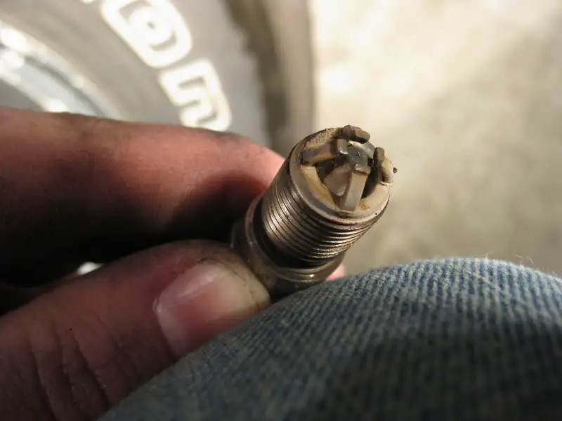

Here is what came out of Deuce.
Let's have a closer look, shall we?
Here is the selling point of the Bosch Jesus plugs. That optimum cleaning temperature. I can hear the angels singing already.
Yeah, well let's look at the 10,080 mile old Bosch plugs, mated to my strong firing ignition which almost always used, and uses still, top tier gas. :rolleyes:
Honestly- the 230,000+ mile stock plugs that were in Snowball looked at least as good as some of these plugs.
We'll go in order from Cylinder 1 to Cylinder 8. Again- 10,000 miles on these pieces of s**t!

Hey- now it gets yummy!

Now, I'm just a wrencher, but honestly- I liked this line:
...and the heat-fused platinum center electrode also offers a much wider heat range than non-platinum plugs.
Yeah Matt, that's when they stay in the f*****g plug. They were just about gone in 6 and 7, and cylinder 8? What the hell was even firing? Was it a lightning bolt from heaven?
or maybe this one:
...the use of Platinum +4 plugs can result in as much as four to five percent increase in fuel economy, plus an increase in performance and reduction in exhaust emissions.
Translated, that means you'll experience that awesome fuel economy, as long as you don't have to accelerate, since if you're accelerating, you will experience missing, searching, and misfiring. The increase in performance is not quite accurate. Some people will, but you, on the other hand will experience a bad miss when you try to accelerate on the highway. That's after a fluttery miss between 20-30 mph. The reduction in exhaust emissions is kind of subjective, because basically what will happen is, since you're running Bosch plugs, your plugs won't fire for s**t. You'll toss codes. Lots of codes. DPFE codes. EGR codes. O2 codes. Then your fuel will go nuts, and well, yeah.
Out with the old, and in with the new. Honestly- stop putting these s**t plugs in your trucks! AAAAHHHHHH!!!!! Bad on the left, good on the Right. Bosch Jesus plugs on the left, Motorcraft your-s**t-just-runs-like-it-should on the right.
Motorcraft in. CEL off. No codes. Fluttery miss from 20-30mph gone.

Deuce was trying hard to get rid of them. The ticking I had on cylinder 6 was simply the Bosch plug backed out to the point it wasn't even hand tight anymore.
F'n things. They just plain suck out loud. :D
