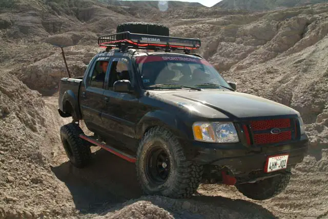

In August of 2001 I made my first appearance modification. I did the Torsion Twist and installed the longer Warrior shackles. I bought the Warrior shackles from Desert Rat Offroad store in Tucson for about $45.00.
After torsion twist and longer rear shackles made by Warrior.
In January of 2002 I made my first trip to an Explorer4x4.com Meet, Truckhaven Run of 2002.
It was at this offroading event that I really began to realize the limitations of having the longest Explorer on the block.
As Rick and other pointed out to me, my step bars would take a beating out there. On the last day of offroading I nailed one of the step bars so hard that I hit it when I opened my drivers door.

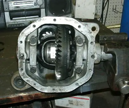

For some crazy reason I ordered a locker for the front D35 differential first. I ordered the Powertrax LockRight from Rocky Road Outfitters, www.rocky-road.com for about $230.00.
It was about at this time that I received my rocksliders from Gloria Zimmerman. So one Sunday, me and my friend Bill proceeded to install the rocksliders and locker in the front differential.
After getting the front differential axle assembly removed from the truck and get the carrier and ring gear removed from the differential, we discovered that one of the side gears for the locker was wrong. I ended up returning the locker to Rocky Road Outfitters. They in turn tried to contact Powertrax to verify that the side gear was wrong. Bad timing, Powertrax had just been bought by Richmond Gear and were in the processing of moving everything, so they couldn't respond to Rocky Road Outfitters. I knew it was wrong, but they had to follow their procedures. Finally, they were able to verify with Powertrax that is was wrong. But it would be sometime before they could get me another D35 LockRight model. So I asked them to refund my money and I called Randy's Ring and Pinion who had one in stock for about $5-$10 more than Rocky Road Outfitter's price. I ordered it from Randy's Ring and Pinion and got it installed the first weekend of October 2002.
Powertrax LockRight installed in my D35/IFS differential

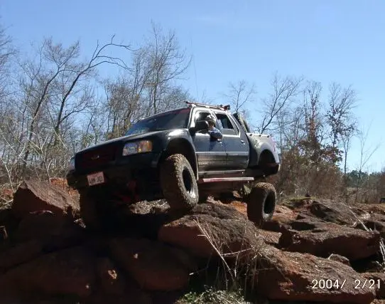

Ok, so now I'm lifted, have 35" tires, and I am locked front and rear; but I'm still having clearance issues when offroading due to my long wheelbase.

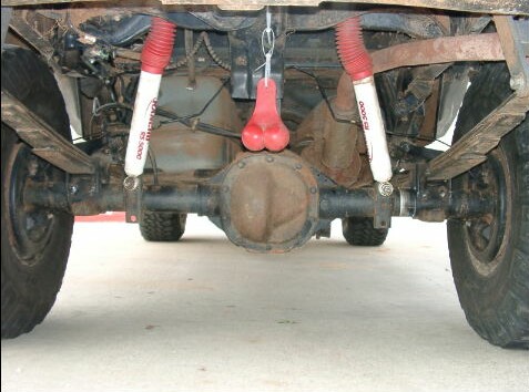

Time to start looking at a spring over axle mod. I started searching all the posts about it on Explorerforum.com. Then I started calling around my local offroad shops for spring perches. I found some generic ones at Texas Off Road Performance for $12.
So in the middle of March of 2003, my friend Bill and I worked on this conversion. We grounded the generic perches to fit the axle tubes, plus created a bracket to elevate the brake line straight up off the pumpkin. Bill had a couple of welding machines available to him, but they didn't do the job good enough. I ended up driving it carefully over to a muffler shop and having them weld the perches to the axle tubes for $45.
After Spring Over Axle Conversion

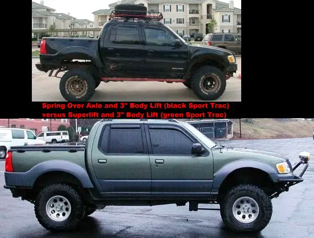

I can get away with the SOA in the rear and nothin in the front better than the rest of you because my Explorer is the longest wheelbase Explorer. 125 inches.
One thing that probably keeps it from looking goofy is my aftermarket fiberglass fenders. With the SOA, the front and rear fenders nearly have the same amount of gap between them and the tires.
Here's a picture before the SOA where you can see the gap on the rear tires is less than the gap at the front.
Here's a picture after the SOA and you can see the gaps for the front and rear are nearly the same.
When I see the pictures above, I hate seeing the gap between the frame and the bed of the truck. But, the reason you can see that is because I took the fender well lining plastic out when I ripped up my fuel filler at Truckhaven 2003. The trail fix for the fuel filler was to shorten the pipes and keep the fuel filler underneath the bed of the truck. But the pro to this situation is I can look through my fender well and see any problems with the brake lines, axle, or driveshaft without laying on the ground. :D
And now let get on with more reasons to not lift the front.
1. A suspension lift in the front does not give me anymore clearance from the front crossmember and A-arms to the ground. Just like the SOA doesn't give me anymore clearance between the 8.8 pumpkin and the ground. Only bigger tires will increase that.
2. Suspension lifts for the front are expensive. The only bonafide suspension lift for the front is the Superlift one and it doesn't really increase your clearance in the front because it uses drop brackets on the torsion bars to keep them in their original positions. Now the RCD suspension lift for the late model Rangers would work, but this is still an expensive option. And is it really worth it??? Not to me since I eventually will do a SAS.
Here's a nice comparison of my truck versus a Superlift'd truck:
As you can see from the pic, I'm doing better than the Superlift. :D
3. As mentioned above I eventually will probably do a SAS. So why waste a lot of money on a suspension lift in the front that won't increase clearance at the A-arms?
I spent about $60 to do my SOA and it increased my frame to ground clearance significantly.
