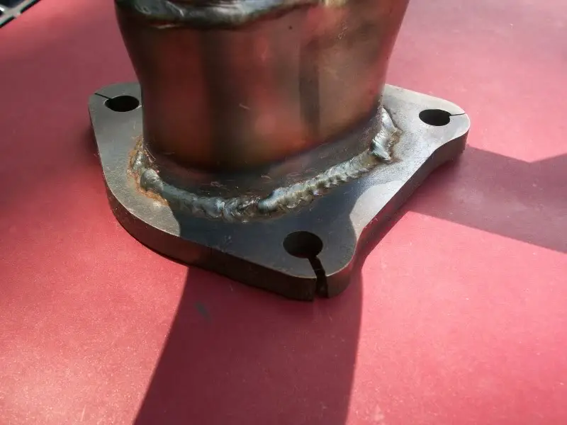

got the y-pipe, it only came to $190.91. the $220 mustve been some kind of security before it cleared.
pics:
get the welds reinforced on the outside maybe?

nice job. Some welding skill there
