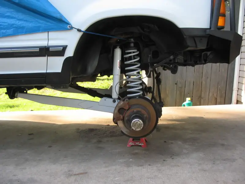

revised shock towers and more flex-Big thanks to Dkchrist for coming over to weld em in. I owe him big time!!

Check your caster again once its all together. :)
Not saying your math is off as im sure its not, but it would be nice to get a finished reading to compare.
Droop, limited by shocks.
Any further down puts the double cardon in a bind--Why?
Ride height, weight is on the axle
Caster angle fully assembled at ride height
It drives a lot straighter with a lot less bump steer, and it doesn't chase bumps like it used to.
However it pulls to the right a tad. It used to pull to the last direction steered, so maybe an alignment will fix that-
Needs longer shocks. :D

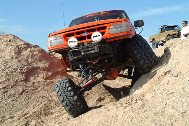

For a trail rig/street driver i wouldnt worry so much about the driveline bind with the front fully drooped. As long as it doesnt bind with the driver's tire hanging and the passenger tire stuffed youre okay so long as you arent jumping it or hauling ass over some really rough stuff. The shaft wont have quite as much angle on it with the front articulated as it will fully drooped.
This is often the nature of low pinion front... you can either lower it, move the front forward, move the engine back, or not jump it. :p:
For peace of mind i would run a center mounted limit strap though- it would be cheap insurance.
Once I get the F250 shock mounts in I think a 19x33 shock will work.
I took the truck to a new fab shop in town-Tuesday they will be finishing up the roll cage shape in the rear, and doing some triangulation supports.
You can barely see it in the top photo, but there is a center limiting strap in there which allows full articulation, but doesn't let the whole axle droop straight down so much. Having the body separate from the axle while climbing steep hills isn't good... It unloads the front end just when you need the weight on it for traction.
