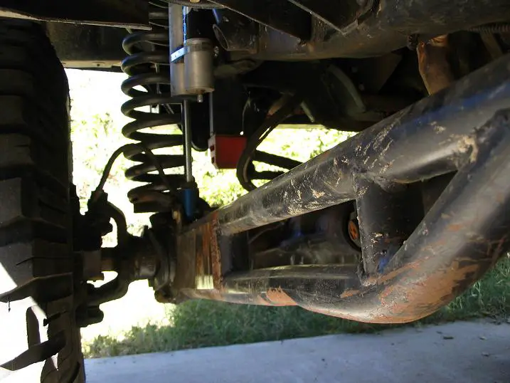

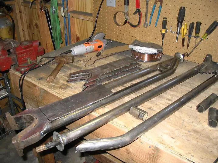

I think i've decided to keep the wedges on the axle and go with something i saw on PBB. I started a thread over their about extended radius arms and got several nice responses. Here is what i'm going to do i think:
See pics below.

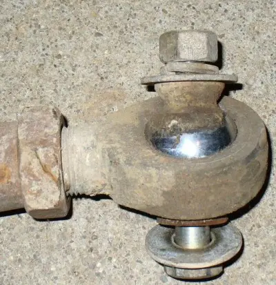

I know i'd put a big heim on the end instead of using bushings and i was alsto thinking about shorting the lower link, you can see where he smashed it on a rock.
On that last pic you can see where his 37's are rubbing. He said if he redid them he's angle the tubing in towards the middle so it wouldn't limit his turning radius, so i think i'll do.

Didn't know that. How's this.

A lot better mate!

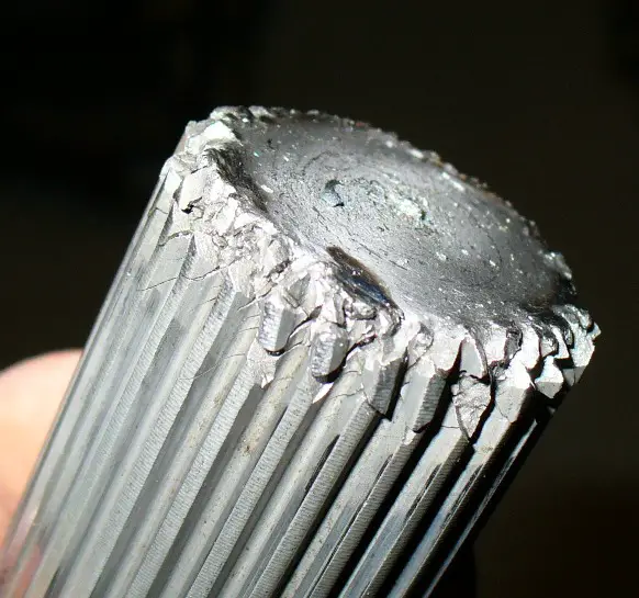

While tearing the D30 apart, i found out why i only had 3wheel drive the last time i had it out down in Crozet VA. Is this bad you think? That is the last place i thought i'd would break to be honest. This is the passenger side that has the vacuum disconnect and that part lived through it!

Thats amazing Josh :D
Weld it somewhere on your Explorer to remind you of the good ol' days :D
I've also got all my old links too, so i've got several different sizes of Hiem joints to choose from. Where can i find the weld in bungs?

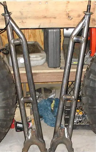

This joint is in 1 3/4 tubing, i'll probably use it for my radius arms mounts. Speaking of radius arms, the pictures i have above of the fabbed arms, how long would the bottom tube need to be you think? I don't like the full length as much.
I wouldn't use heims on my suspension links. I would use some poly bushings on one side and some Rubicon express superflex joints or simular. Since you already got heims on one end, I would use some superflex rebuildable joinmts on the other. You can buy the weld in bungs from a ton of places. Try poison spyder customs. Thats where I got mine. I also found a better way. A local machine shop built my last links. He threaded them on his lathe. Turned out super nice. Cost me the same. He even ordered my DOM in in the right size to be threaded.
