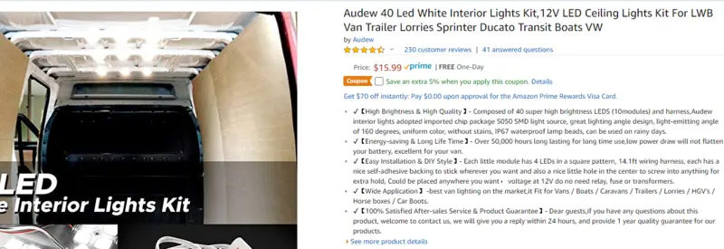

Now I'm working on installing some LED light strips for interior lighting, and finishing my center console. I'll post more pictures when I get further along on that project
crashhard
May 15, 2018
125
80
Las Vegas
1992 Explorer Sport 4x4
I put (1) set of these down the center of roof and it lights the entire interior. You have alot more in your ex at the moment but (2) rows of these down sides will be daylight inside. These are bright.

Thanks dude! I have 4 small LED strips in there right now with 2 sided tape to the roll cage. One on the windshield bar, one on the main hoop at the B pillar, and 2 in the hatch area on each side. I was waiting on my new switch panel to come in before I finished the wiring, but should have them all good by this weekend.
