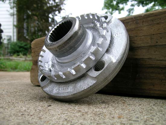

Chances are, the Jeep tone ring wont have the same number of notches as your Explorer's. So after you wire it in, there's a good chance the ABS system is going to go crazy because of the mismatching signal.
I wouldnt worry about the ABS, thats one of the smaller issues you would be facing. Its not too difficult to make a tone with with an angle grinder. This is what I came up with since the GM 14-bolt axle I swapped in didnt have one. Its a Dana44's carrier bearing race sliced up to match the original tone ring's teeth number divided by the axle gear ratio (since its transfer case mounted).
