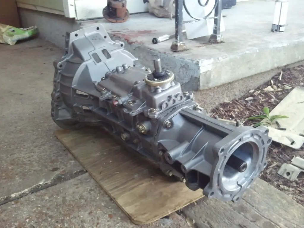

I did find a shop that sells reman and dyno tested units for $700, which is not a bad price, but way more than I wanted to spend. That's why I took a chance on a used transmission.

There is a local company that remans locally and sells nationally. So for $700 I can have a basically new box with a warranty, tomorrow.

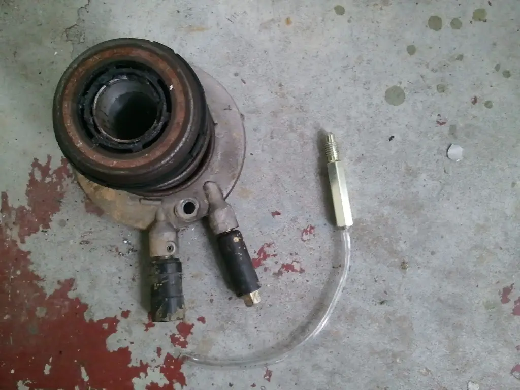

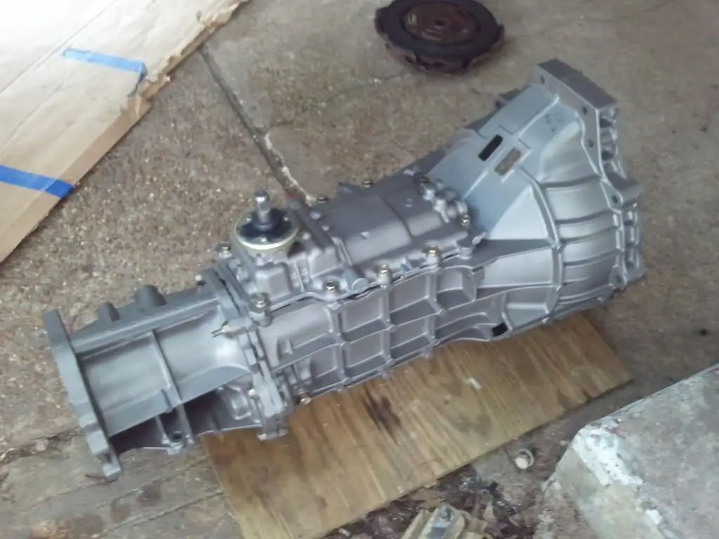

On the plus side, the new trans is in, with the new slave and clutch. I'm going to make a gasket for the tail shaft to t-case from paper gasket material. Really, all I have left is the t-case, drive shafts, fresh lube, and bleeding. I think I'm going to try and find a better fitting for the slave cylinder. One that will allow me to put a bleed hose on a nipple. Neither my new or old slave have nipples and bleeding them is a real mess.

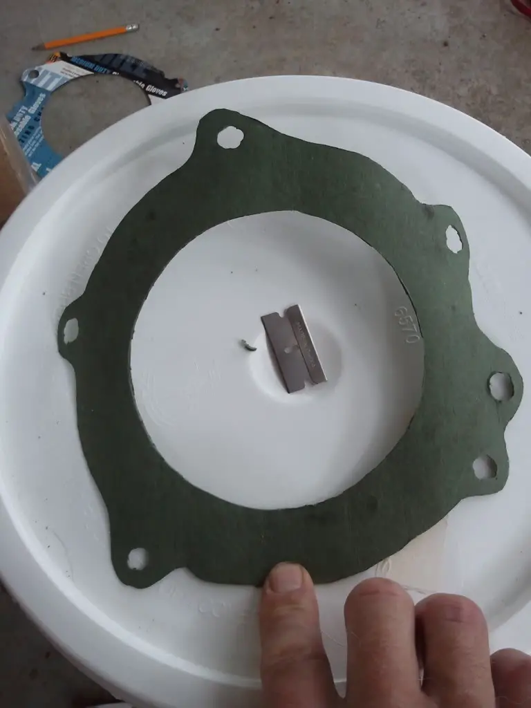

Remember I said there was no gasket locally, and I abandoned mine with the old transmission... I made a new gasket.
Perfect? no way. but I have confidence it will work flawlessly.

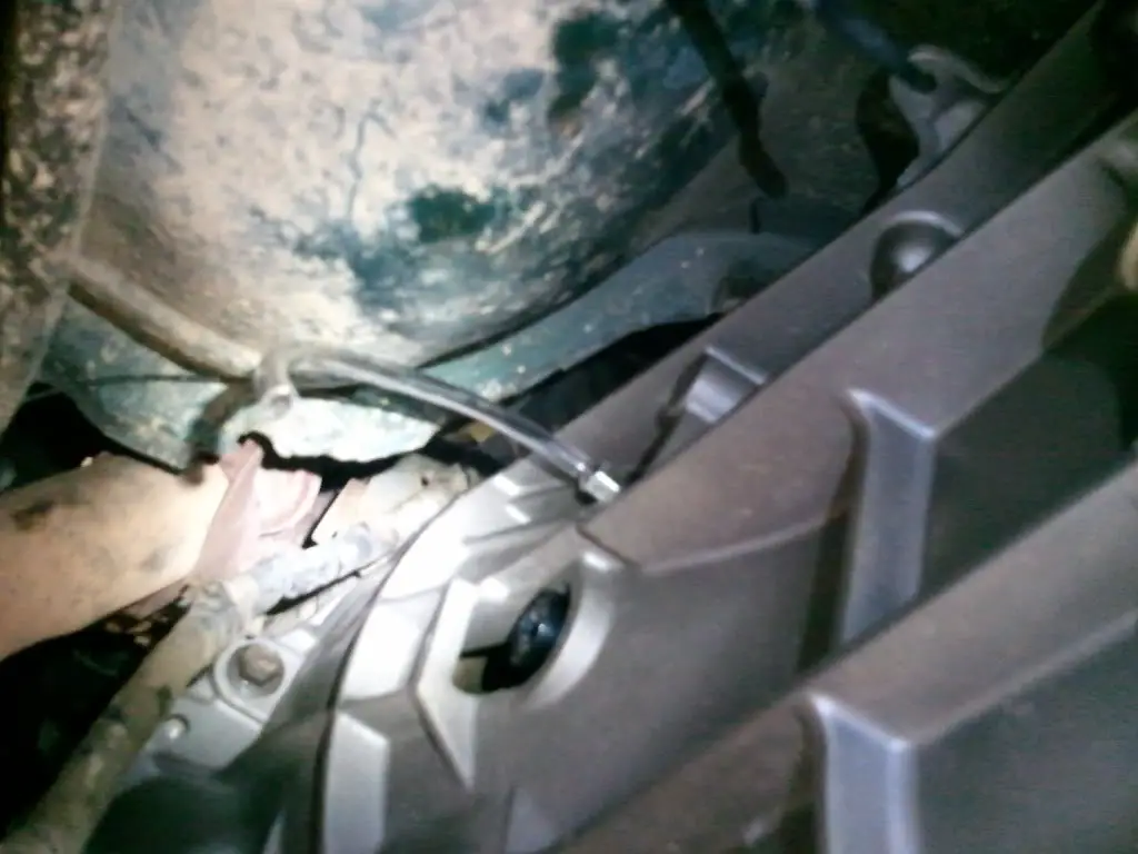

I could not find anything that would work to add a bleed nipple to the slave cylinder. So I came up with this. It's a poly hose that is just a little too big for the hole. I pressed it in nice and tight. At least this way the brake fluid won't spray and drip all over the place. I haven't done any bleeding yet. I had to stop 'cause of my wife's social calender. We have to attend a double retirement party.
Finally got the thing back together. Thought I might share a couple tricks I used. My little bleeder hose worked great. I still have a little air in there, but the clutch works, just with a really light petal. It was also clean. Every other time I've bled this clutch it was a real mess. I just added a longer piece of hose into a bottle, no mess.

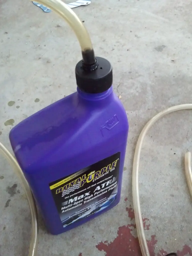

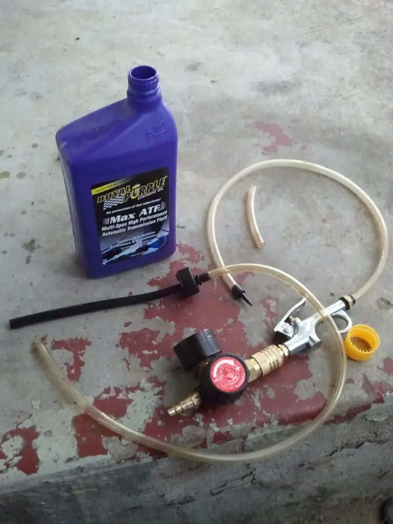

Now onto how i filled the transmission. Normally I use a funnel under the hood with a long hose to the fill hole, but it sucks and is messy. This time I made a hole just big enough in the lid for a piece of hose. A little hose connector from my vacuum pump kit, and a few other parts from the same kit. you can see the really tiny hole next to the hose in the lid. I used a small funnel looking thing from my vacuum pump kit, connected it to my air blower with a dial to turn down the pressure. I pressurized the fluid bottle to about 2 PSI and the fluid traveled up the hose into the transmission. No muss no fuss. Pay no attention to the small piece of hose. At first I just had that coming out of the top of the bottle and was manually squeezing. After about 15 minutes, my hands were tired and I had only added 1.4 quart. so I made this doohickey. :salute:

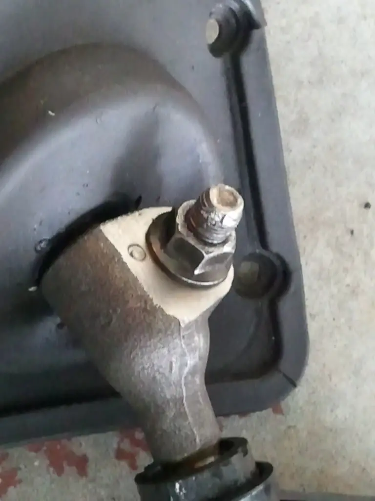

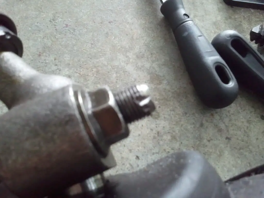

Lastly, a picture of one of the many thing that stupid redneck did to this truck. I guess he didn't know to remove the shifter one has to remove the nut from one side and tighten it on the other to pull the shaft out. He, used what I guess is pliers to try and pull the shaft out the wrong way. I had a time cleaning the threads enough to get a die on it.
