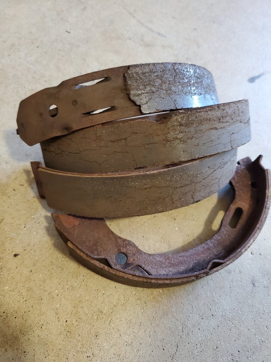

When I got the Mystery Machine in April 2018 the parking brakes did not work at all. That was a big problem since it's parked at the top of my steep driveway. For the first few weeks I put blocks behind the rear wheels to be safe, then finally took it into a local, supposedly trustworthy shop for diagnosis. They said "oh, you need new brakes all around". Hmm, ok, well I hadn't put any money into it yet so if this is all it needs... of course, that was followed a week later by the starter and a few weeks after that by the fuel pump. Had I known, I would have done the brakes myself since I can do those, but don't want to mess with fuel pump/tank.
Fast forward 4 years and lots of knowledge gained from this forum. I just replaced the upper control arms and all the pads myself (rears getting thin) and checked the parking shoes while I'm in there. No F'ing way those were replaced 4 years ago. They were cracked, rusty as hell, and one of them had a big section of pad completely missing. They look like they are probably the originals. So I paid for "brakes all around" and basically got new pads and a professional to turn the parking brake adjuster?
Anyway, just now replaced the shoes. I won't say the parking brake is working any better or differently than before, but I sure feel better.
I dont want to defend any crooks. My wife has done that to me several times by driving off with the parking brake on. Overheating the steel makes it prone to rust fast, cracks the shoes and drasticly shortens their life.
