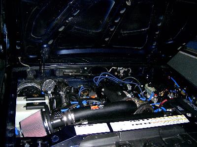

Here is the best pic I have of it installed, Sorry that I have no close ups of install process, but trust me it is a no brainer.
