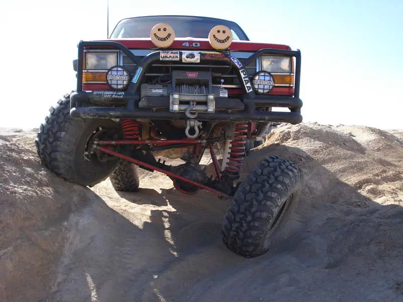

I have a 1st Gen XLT w/ Auto tranny. It was nicknamed The Big Model by my neighbor and is not affectionately called the Black bitc* by my Wife. I currently live in Mount Vernon, WA.
So far I have added:
  • Front solid d44 with 79 bronco coil buckets, F250 shock mounts, 5.5" Wild Horses Rock Crawler EB springs, and chrome molly axle shafts.
  • Front diff guard and custom steering links
  • Rear Spring Over Axle with Old Man Emu 2" lift springs and a couple leafs from a stock pack
  • 36x13.50 IROK's on 15X10 Eaton beadlocks with a 2.5" backspacing
  • 4.88 gears front and rear w/ ARB air lockers front and rear.
  • Rear TA support diff cover to protect 8.8 and ARB
  • Advance Adapters installed a 700-R4 and the kit is now available.
  • B&M truck megashifter (floor mount)
  • Additional stock type transmission cooler (2 total) with an external tranny filter from permacool
  • Atlas II transfer case w/ 3.8:1 gears and 1350 u-joints
  • Smittybuilt winch front bumber reinfoced with 2" square tubing and an added receiver hitch for a front tow point
  • Smittybuilt rear bumber modified w/ a reciever hitch and swing out tire/hi-lift carrier made with a trailer spindle as a hinge.
  • Full Internal roll cage built by myself and tdavis
  • KKM Sport Induction air filter
  • Borla catback exhaust modified to exit at side
  • Warn HS9500i winch
  • Rancho RS9000 rear shocks / RS9000X front shocks
  • ARB air pump provides on board air for tires and ARB air lockers.
  • Custom Rock Sliders built by arsoul
  • PIAA Superwhite replacement headlamp bulbs
  • PIAA 520 fog lights (1 pair)
  • KC 150 watt Daylighters (1 pair)
  • Extra reverse lights mounted to tire carrier
  • Rock lights above rear axle facing the rear and behind the front tires facing the front.
  • Dual battery system utilizing 2 Optima yellow tops and the ABS relay circuitry to control isoltion of the second battery.
  • Cobra 7 CB w/ 5.5' Firestick antenna mounted to rear bumper
  • AGR Rock Ram Hydraulic Assist Steering.
This is phase one.
