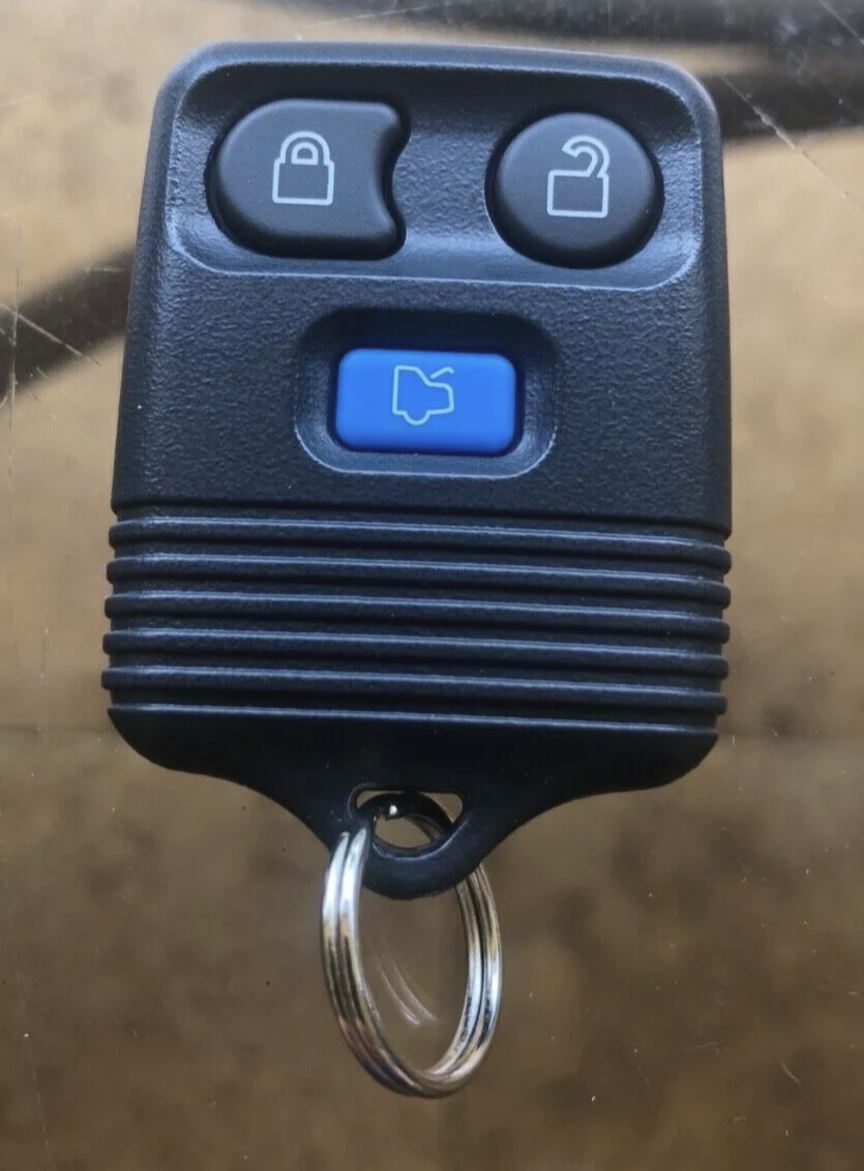

I recently purchased a 2014 PIU that came with one standard fleet key and no fob. I purchased two of these fobs off of Amazon (https://amzn.to/3qnSHVR), but can only get one to program. Ive gone through the off/on cycle and was able to program one of the fobs, but for some reason the 2nd one will not program. I know the fobs have to all be programed together, but for some reason that second fob is unresponsive. I even tried the cycle multiple times starting with the fob that wouldn't program and a old square fob (seen in the pictures attached) my dad had and regardless of the order that one Amazon fob is the only one that will program. To make sure I wasn't moving to slow for the program I put the one working fob last in the sequence and it's still the only one to program. Anyone have any ideas what the issue can be? I've tested the batteries in the two non working fobs and they are working they just won't program.

Pretty sure the old style fob won't work (not one that old, I have the one generation older that came factory on my non-PIO '14 (with the remote in the head of the key) and that works), and since you changed the order of programming them, most likely the questionable FOB is DOA and you should ask the seller to send another or refund.

Thanks. I'm thinking the one that did come is DOA, but someone on FB told me their '13 only allows them to program one Fob at a time. I ordered a replacement fob for the one we both believe is DOA.

I fixed the problem! The fobs that wouldn't program were defective. I sent the defective one's back. I programmed two of these https://amzn.to/3KWGvDD (the one that didn't work was defective) and one of these https://amzn.to/3K20XSh to my 2014 PIU.
