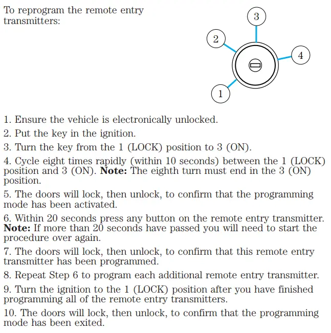

Hello everyone,
I have a 2010 Ford explorer and my key fob that i bought has stopped working, this is my third key fob that has just stopped working. I replaced the battery and did the programming instructions thinking i needed to reprogram the remote, but this has not worked. The car will go into programming and when I press the buttons on the remote it makes me think it has programmed, but when i exit out of the programming and try the remote, it will not lock or unlock the car. Any help is much appreciated!! Thank You!
