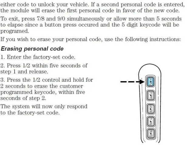

BigRondo, tried it the way the Owner's Man says, but after reading it carefully this method is for adding a second code to the KES. Is there a way to reprogram the original code or do I need a new control box?
I found the numbers and tried all the above and other internet post on how to change, erase old personal numbers and still does nothing. The only thing I can do is lock the doors with holding the bottom two buttons......

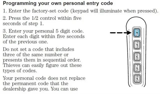

I would start by disconnecting the negative cable on the battery and leave it off to see if this resets the computer.
If this fixes the issue, then you can program a personal code. The instructions are in the owner's manual. If you don't have an owner's manual, Dead Link Removed.
Here you go:
I'll see what my shop manuals have to say about the keypad not working and post and pertinent info.
Hope this helps out. :biggthump
