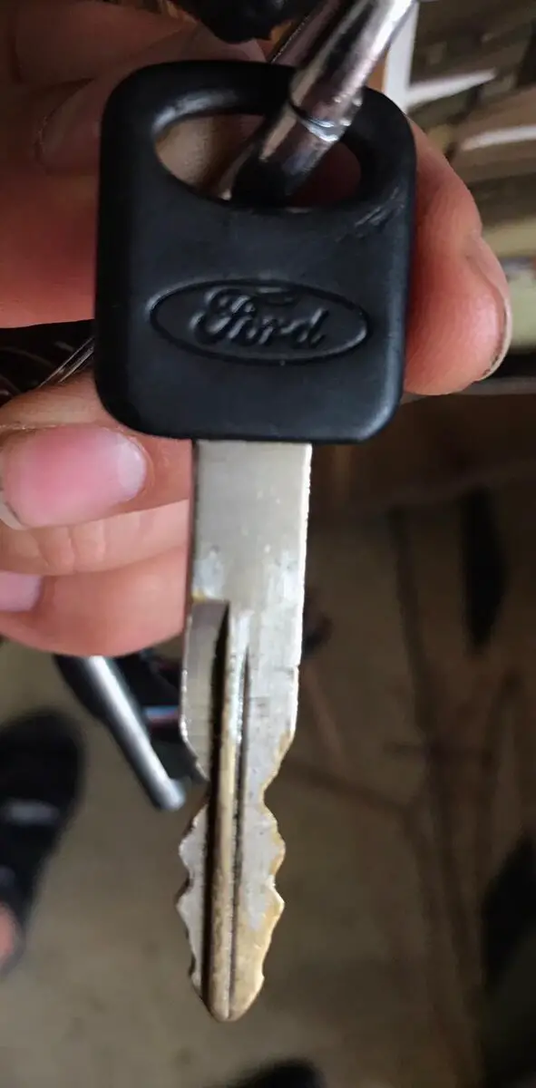

Hello,
I wanted to program a new remote control according to the instruction manual, but after inserting the key in the ignition and cycle eight times rapidly the door does not lock/unlock.
(The lock / unlock buttons on the doors are working)
I have only one original key without a remote control (as in the photo), is it possible that I do not have the control unit or it has been disconnected?
I will mention that my immobilizer does not work in the car, at the locksmith I made two keys with remote controls and ... surprise ... I started the engine before we programmed the transponder chip; p
Now I do not know if it is possible at all.
Thanks for any hint ;)

These vehicles do not have PATS or chip keys. They use old school "fleet" keys...

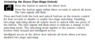

I don't know if the following will work in your case since you don't have the RKE settings.
SanSebek
July 18, 2021
60
12
Brzeg
2015 PIU
Eee..It doesn't work ;(
In my PIU 2015 manual, the procedure is exactly the same.
A small note - when unlocking the door remotely, the parking lights come on, not as described in the manual (The trun signal will flash).
Anyway, as already mentioned, the procedure for adding a new remote key according to the instructions is incorrect (no relevant information that the driver's door must be open!). So I am not surprised that the above procedure (Disable two-stage unlock) also does not work; p.
Maybe in Forscan, in addition to turning on the RKE, something else needs to be done to make the RKE settings appear in the car.
