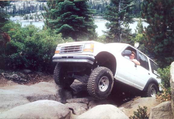

You mean this Rubicon I did in my daily driver?

My truck pictured had the Trailmaster 4" lift, stock radius arms, no sway bars, WARN manual hubs, 35s, glass front fenders, detroit in the rear and TrueTrac in the front. It was a very capable rig and served me well as a dd/wheeler for 4 years.
If you really want to do the SAS, and are actually going to use the truck off-road, I would get the d44. There is no point in downgrading your front axle just to have a project to do. If you do the Rubicon or even Moab (some of the harder trails), you'll be snapping shafts. This is also not a good reason:
