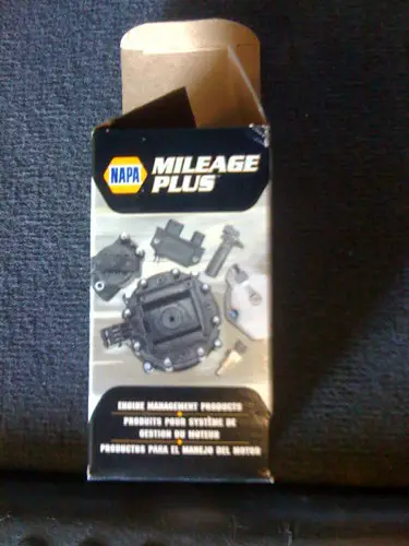

This is the box for the ignition switch we used
